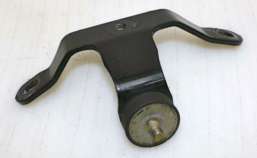

Makes you wonder whether the relatively soft rubber mountings of the M3W engine actually contribute to the vibrations? Of course, the mounting in the bike frame would also include a top mount which may also help. Something like this:

Hadn't considered a top mount. Good thought!

Having just made a lifting bracket (in anticipation of a Bleazey job on the Centa) and recognising that the threadings for this are the top mount for bike installation leads one to wonder (as Andy did above) that if a brace could be conceived it could damp the engine's movement very effectively - there is a lot of mass flopping around quite a long way above the soft rubber mounts so the amplitude and force of the vibration is no surprise....

From the S&S engine installation manual.
ENGINE INSTALLATION
Due the unique engine mounting locations a frame designed for the X-Wedge engine must be used. The engine must be mounted using the four mounting points on the lower cases and with a top support between the cylinder heads that is tied into the frame. The top support brace must connect the 3/8”-16 tapped bolt holes located on top of each cylinder head above the intake port and 7/16” grade 8 bolts must be used in the lower mounts.
