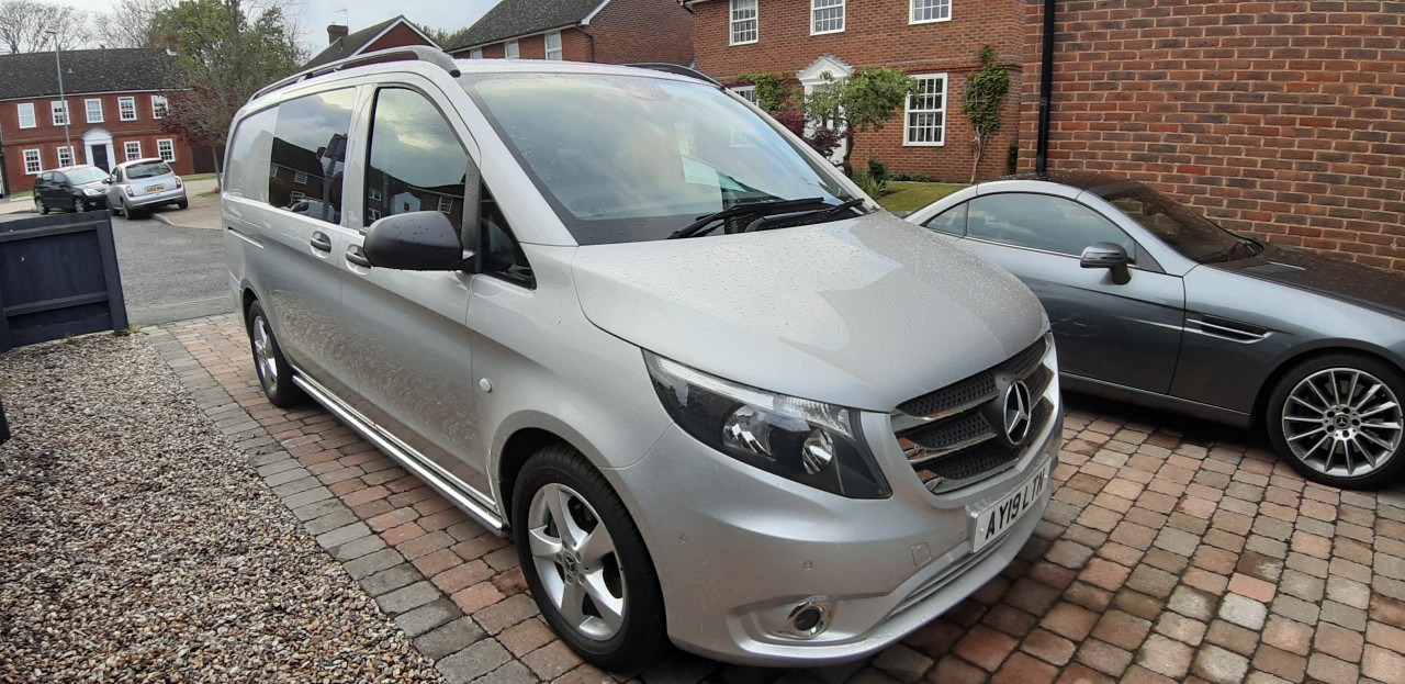

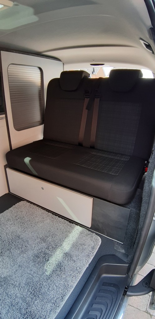

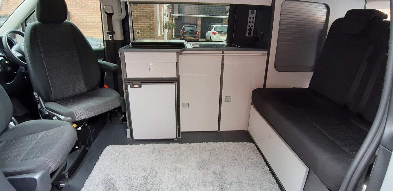

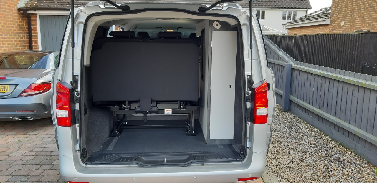

Thought some of you might be interested in my winter project, which was just completed in time for lockdown! Last year I bought a new Mercedes Vito 119 Sport Crew Van as a basis for a camper; mainly as a retirement project - but then I found myself working again! So much of the work was done in winter and often in the dark! I used a furniture kit designed for VW T6, which required a LOT of modification. I had a pull-tested rock and roll bed made and fitted as I wanted it to be safe. And I fitted a combined diesel hob/heater, full electrics including mains hook up, sink, and seat swivels for the front. The two worst jobs were dropping the fuel tank to install the heater feed, and cutting a hole in the pristine roof for a roof vent. But all done now, and waiting to go on an adventure....
Hopefully the pics work - first time I have tried using the Talk Morgan Image Library.

Well it was cheaper... although I wanted a decent van with good quality stuff inside so that it lasts. So its a top of the range vito, but at a big discount as they were changing the engine lineup. So it was £31k. Mind you it is 190bhp with air con, camera, sensors, self parking, auto, and a sport pack... so we could have gone cheaper. Inside is about £7.5k of fittings... the bed was 2.2k fitted but its beautifully engineered and matches the upholstery. The heater/hob was £1.6k but does two jobs and keeps the van gas free. The electrical gubbins were a tad expensive as the van is euro 6, so charging the leisure battery needs rather more than a split charge relay. But I saved by making things myself, like the electrical control panel and the support for the upper cupboards. So £38k for a van the meets our requirements exactly... I'm quite chuffed.
