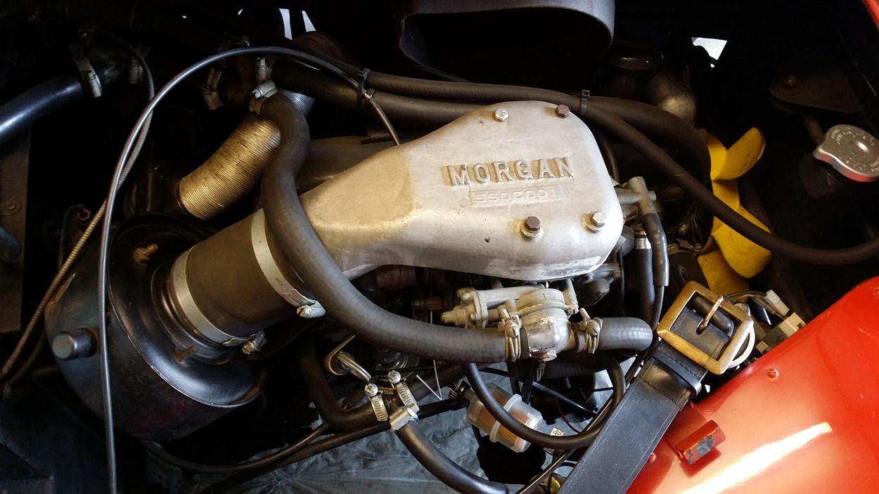

I do not even know where the air filter is located.
On the top of the cylinder head cover there is a
kind of silver metal "cap". On the front grille side
it's round, on top it's flat with huge letters "MORGAN",
on the windscreen side there is a short but quite large
tube, connected to a black "pot" which has a kind of
snorkel on it's side. Maybe the air filter is in there?
Unfortunalely I don't know how to post a picture here.
Thank you for your answers!

Bert, I looked at John Worrall`s book "Original Morgan" to find a pic of what may be an engine bay like yours, and from your description and the pic in the book, the air filter should be inside the black "pot" It seems there may be two different Ford engines that were fitted to Morgan 4/4`s as Rob posted, and it may be that the two different spark plug types that Arwyn suggests cover both versions...? While it seems wise to suggest it would be ideal to identify which engine you have from it`s numbers..? However being a Morgan there is ever the chance it may have been modified by any past owner..?
As for posting pics, the process can be frustrating to begin to attempt, as the logic involved seems illogical other than to those well used to the ways of the web, however it can be a slightly more logical process to post in the Morgan photo gallery, direct from your device, though the forum has size limitations, so perhaps best select a reduced size image from your device or photo programme.. To post a pic in the thread takes a little more determination/frustration to overcome but worth learning in time..Even I managed it with the help of Heinz and others..

I've already sent a picture to Richard (+8Rich), he will post it here and hopefully everything will be much to understand.
The engine is the original one, I E7-A3427.
Back from the shopping trip Bert ;-) with love so back on the desktop, my fingers are too big for iPhone typing..
