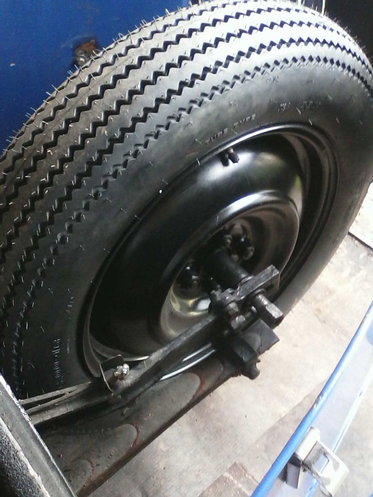

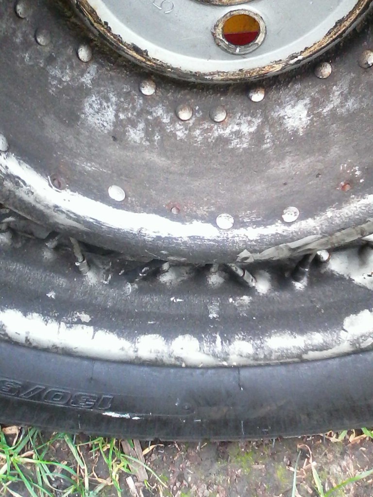

My 1934 Morgan SuperSports has, over the years suffered from spoke breakages in the rear wheel. This has usually been one at a time, however after the Vintage Revival at Montlhery in 2019 we drove back to Somerset with no problem.
A week or two later I was checking the Mog over ( something all Morgan 3 wheeler owners should carry out regularly) when I could see the heads broken off six spokes in the rear wheel. Outward appearances all spokes looked intact. The wheel had been respoked a few years earlier so they were not old spokes.I fitted one of my spare wheels for the rest of the season.
The rear wheel on any three wheeler is a vital part and everything should be 100% fit for purpose. A Morgan with two people in it and lots of luggage is placing a great load on the rear wheel. I decided that the way forward was to try to find a steel rear wheel to do the job.

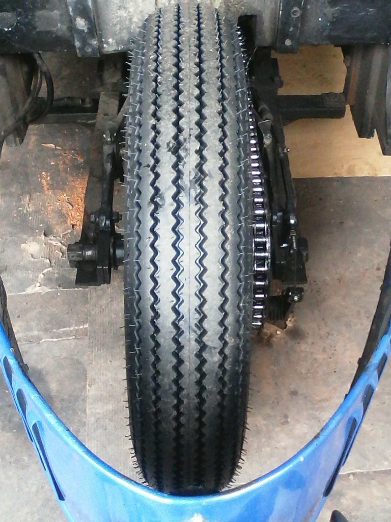

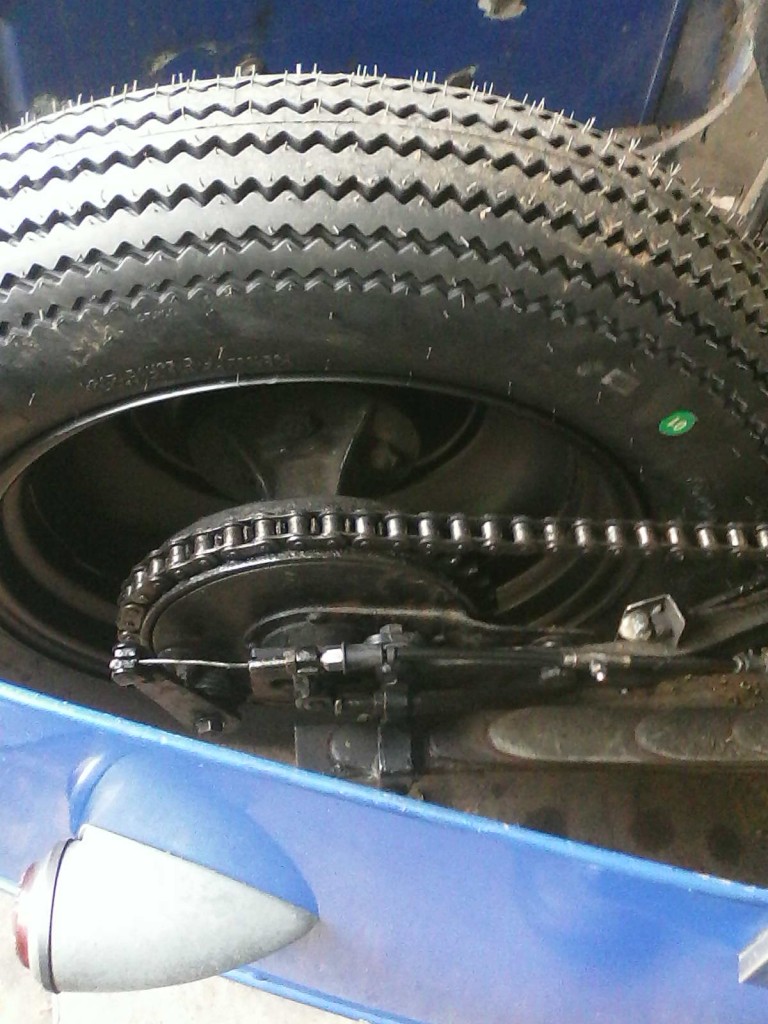

The main problem on a Vintage Mog is that space between the rear forks is limited. I started to look for Space Saver Steel Wheels that might do the job. Much google searching came up with a Toyota Yaris Space Saver of 16" size as being a likely fit.

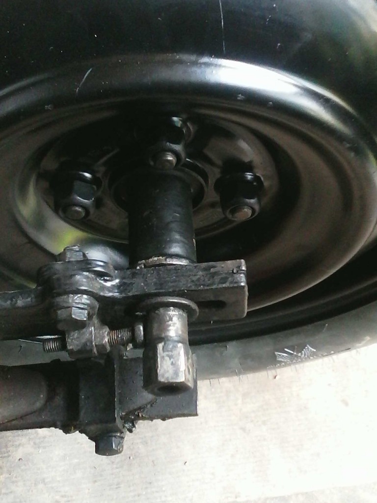

Only certain models have the correct Offset of ET39, their 4J rim was about right too. Patience on good old e-bay and a brand new one turned up in Newton Abbot for £4.99 unused since new, I could not believe no one else bid and it was mine.A trial fit showed it to be exactly the same profile as the Magna original. Only modifications I had to do was machine a small amount from the N/S spacer and machine a 60 deg taper onto the Morgan wheel nuts. Junking the space saver tyre and fitting a 500 x 16" tyre brought the rolling radius up to exactly the same as the original rim and 18" tyre, so the speedo readings and gearing all stayed the same. As usual I applied some puncture preventative sealant to the tube, I prefer the stuff from www.autoseal.co.uk you do not want a rear wheel puncture ! A Mog is uncontrollable if this happens, I know.
This lockdown project is now finished, just need permission to go out on the road from Boris.

Interesting info Ian, I've been contemplating this for the F Super
Are the PCD stud sizes the same ? and could you give a bit more info on the NS spacer machining ?
