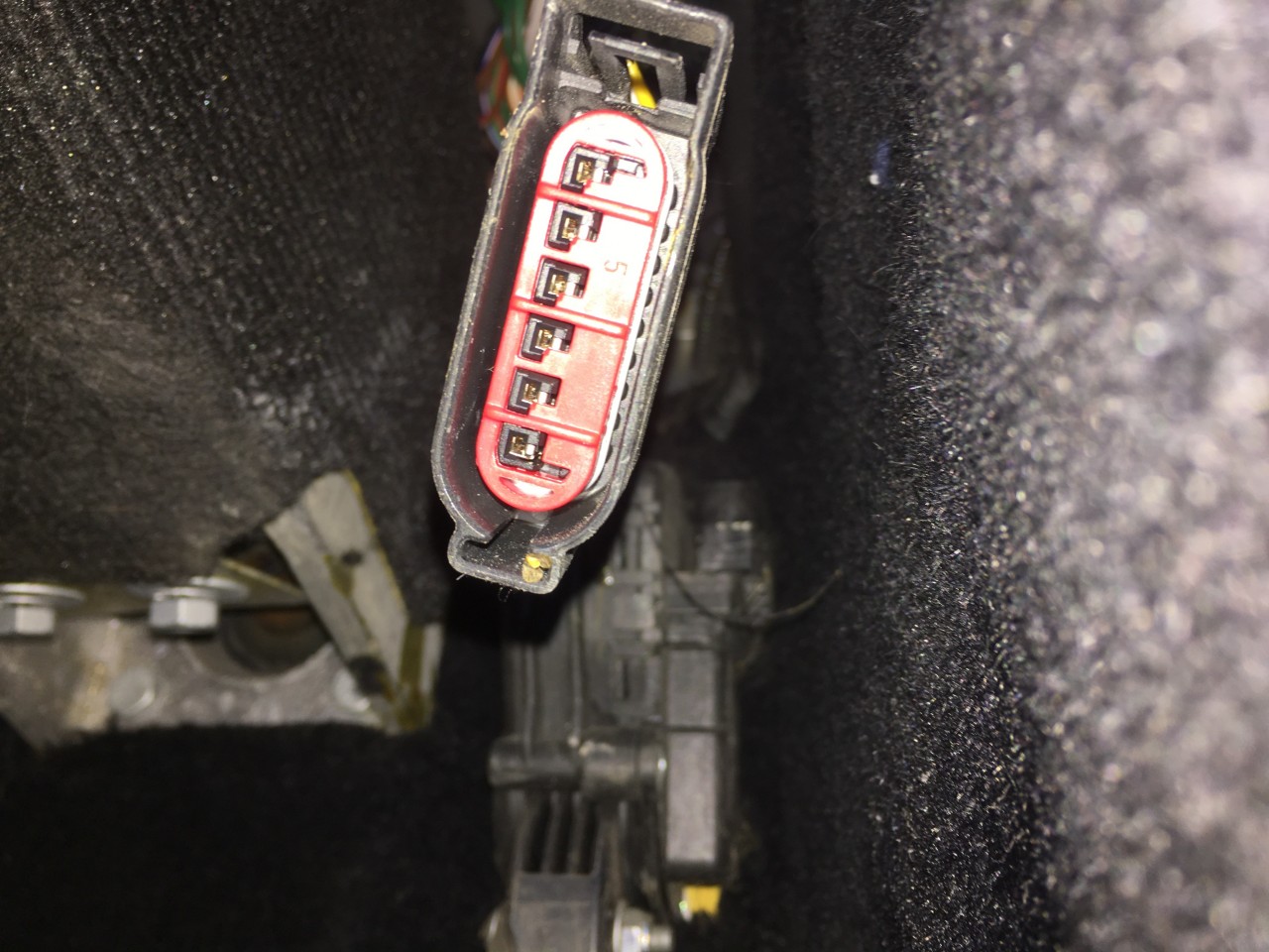

Crumbs what an effort to get that off. Only achieved by lying across both seats and using two screwdrivers. Hope I don’t need to do that when I’m 80. It looks pretty clean to me but I have squirted it with contact cleaner, now just waiting for the roads to dry off (or it’ll be back to Craig’s)
So, finally managed to get the throttle connector off and sprayed it with contact cleaner, then off for a blast and, the fault is still there. Bit windy though, isn’t it?
