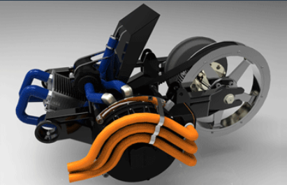

How about this concept from Garage 56

Still a belt drive there, but no idea what the rest of the gubbins does!

Looks like an electric drive with water cooling for the motor.

Looks like the drive train from the EV3
Red Leader drive
