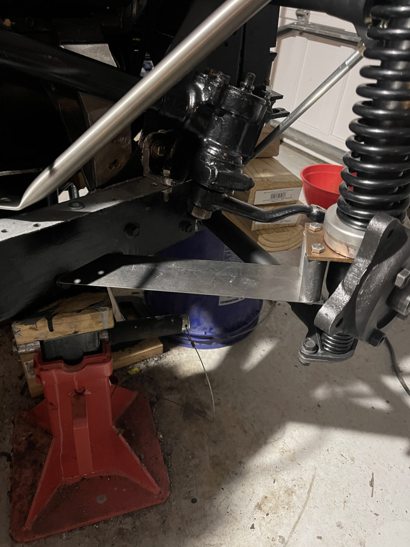

Hello all - nearly 2 years later, I have completely taken down my front end, replaced the cross head, rebuilt my C40, upgraded to narrow pulley, and am getting things back together. I have the new Rutherford suspension kit on and I think I’ve messed up a bit. My steering dampers look way off. See pic, I know they will not line up with the suspension unloaded, but am wondering if I should have placed the bronze plate on top of the steering bearings, rather than under. I have an email in to the folks at New Elms, haven’t heard back yet. Anyone have thoughts?

You don't run the damper blades with the steering bearings- it defeats the object of them...

So at this stage would you suggest removing them completely and seeing if we are shimmy-free at speed?
Is there downside to putting them above the bearing? I would think that would let the steering bearing do its job for the stub axels, while keeping the damper function. May just not be necessary though.

I did the conversion on my 97 +4. It worked well. Some people report the need for a steering damper. Look up GoMog on the web on this.

I didn't get a shimmy when I did my Roadster, but the steering was really light and I was advised to add a damper which just gives it the right weighting.
