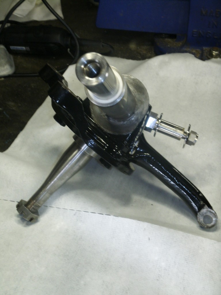

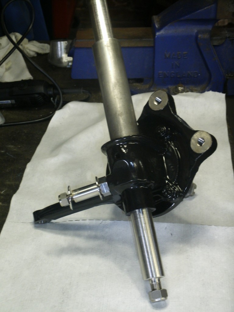

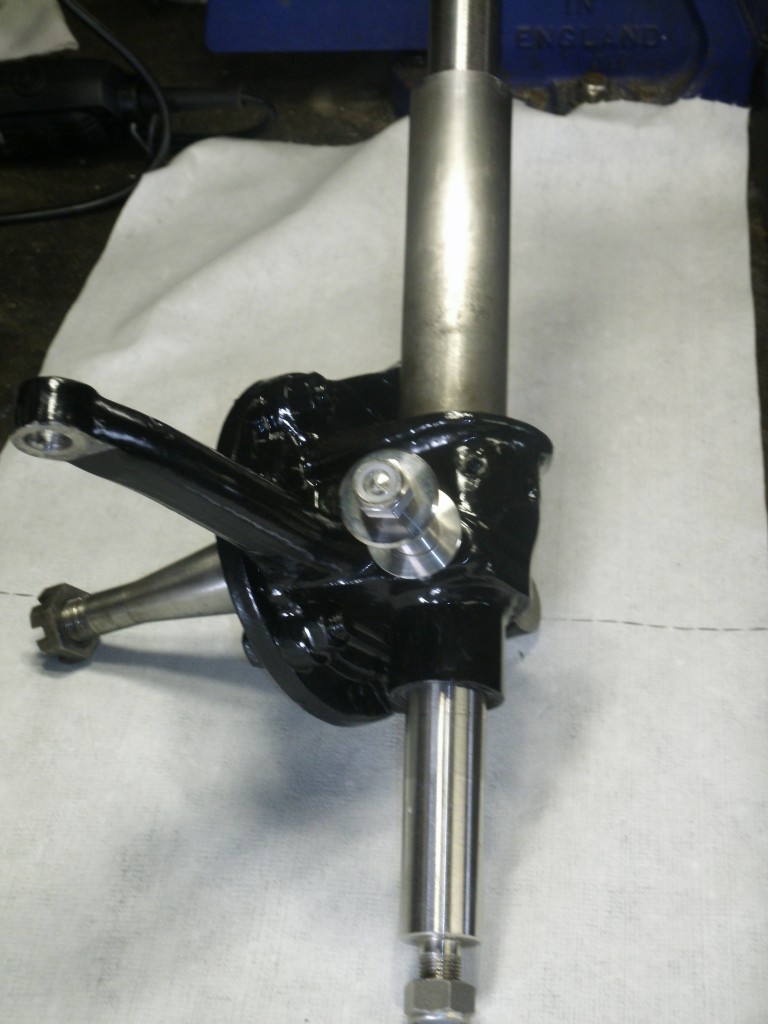

Why not ? It's not as if it takes a lot of effort. A wire bush, a bit of masking tape, slap on the chassis black and Bobs your uncle

Nice work! You’ve convinced me!
