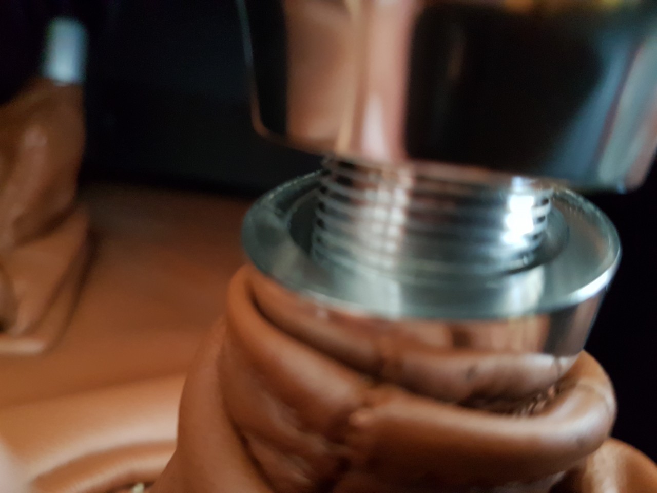

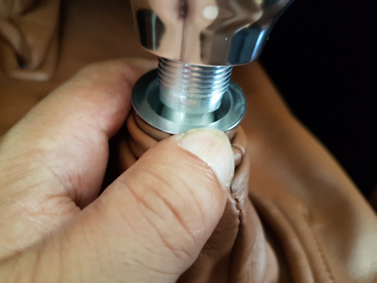

Hello to all,
if have a problem to get the gear shifter nob of. Need to do this because have to repair the leather cover of the kardan tunel.
The Ring below the Nob is of, but i can not find any srew or something.
Thanks a lot
Its a 4/4 Sport build 2011

On mine with the ring off there are 3 very small grub screws. But mine is a Roadster. Maybe the knob then screws off. Hopefully someone with your type of car can comment.

Thank you John.
At my car there are no grub srews. Maybe i have just to spin the knob harder but i dont want to destroy something.

Dani
Push the leather right down as there are Allen Key small back grub screws there. The thread only holds the lower ring cover in place.

Hi Colin
thank you but i can not find the grub srews.

The screws are right up near the top of the thread and very small, get your head down lower and look up to see them. Don't drop them they are tiny and stainless so a magnet won't find them ( experiential learning!)

Plus you don’t need to take them out, just slacken and the knob pulls off
