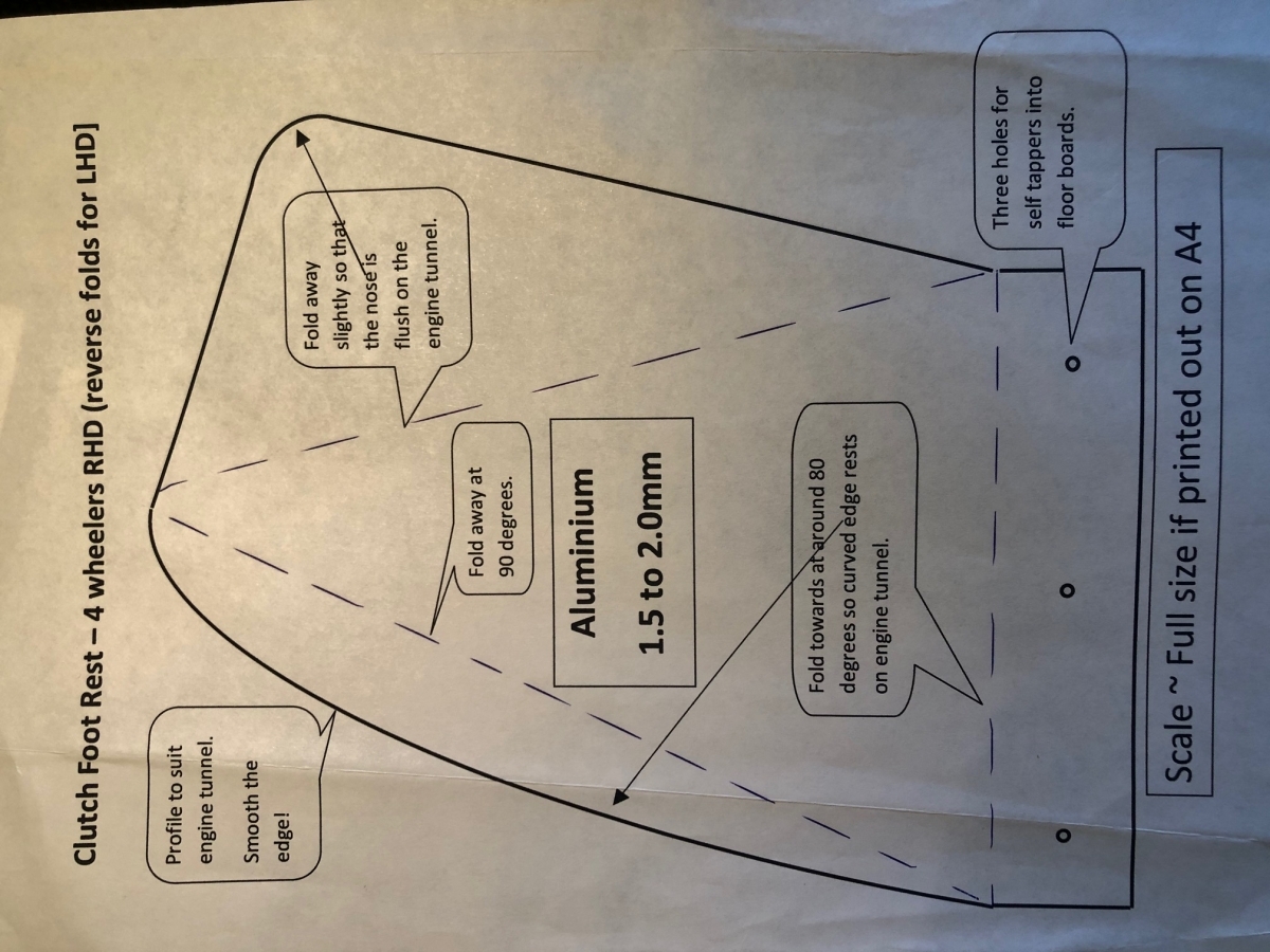

Clutch Foot Rest
Template for Clutch Foot Rest

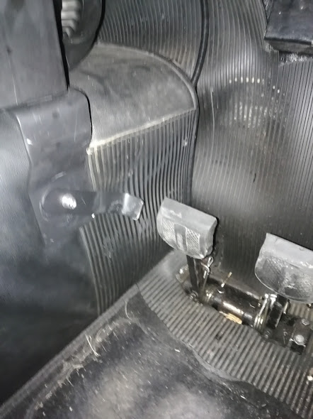

Went for a much simpler option. Does the job.
