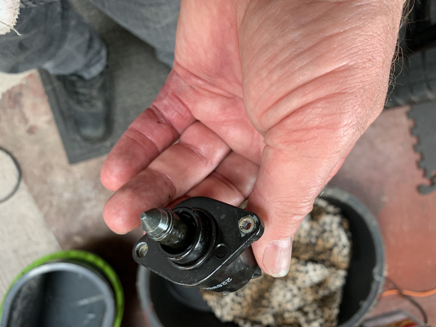

I also have occasional slow return to idle, and have just got round to checking it.
I have checked the throttle linkage etc and all seems ok , so I want to check the Idle Air control described above as being on top of the throttle body.
Is it this ?
If so what do I clean? it all seems clean to me !
Thanks

That is indeed the ICV. Not easy to clean, but I use aresol Carb Cleaner to blast stuff out. Be careful not to try to dismantle as the plunger is under spring pressure and if it fires off you mauy never see it again. Also clean the inside of the plenum/inlet manifold to clear gunt too.
