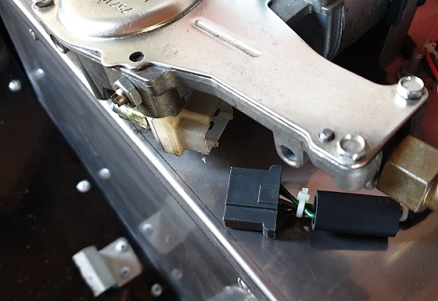

In terms of an ignition on live take off point any suggestions for an easy to get at scotch lock wire?
Nice work Ian. I think I might have gone down this road had I had wing lights.
If you are just looking to take a low current feed then perhaps connection I/D G44 (from the chassis harness diagram) on the wiper motor connector. It goes back to the 10A wiper fuse and on with the ignition.
Thanks Roger. just ordered a 12v tester so I am going to hunt around the under bonnet fuse box and certainly the wipers must be a candidate. However any source I use must be Ignition on/permanent live and not switch dependant. eg like the 12v socket in the glove box.
I have also ordered an automatic voltage sensor relay that is wired into the dimmed headlight live and reduces volts to DRL by 50% when ever dimmed headlights on. When on main beam DRL remain on.

I suspect even with a 50% voltage drop that LED's will still be just as bright, they have a very wide operating voltage

The best way to dim LEDs is with a pulse-width modulation system - this turns them off and on faster than the eye can see, and dims by changing the ratio of off-time to on-time.
They are easily found, here's an example of an adjustable one, although in this application a sealed waterproof one might be better.
If thats the case I might have to fit a relay that switches the wing mounted bullet lights off when on dipped beam.
