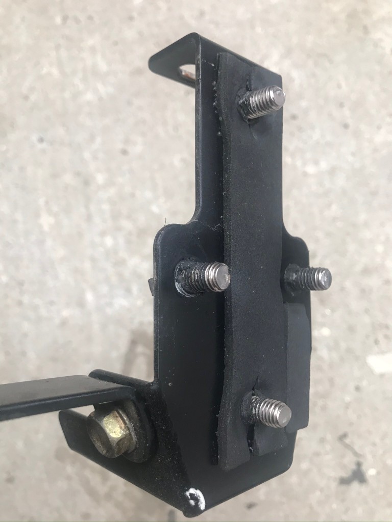

Think it would be better if the G56 brackets had 4 bolts like the later OEM brackets rather than being based on the early 3 bolt brackets.
With the G56 ones being wider there is more leverage and the extra length below the bottom bolt there is a far bit of flex of the side skin.
If I was doing it again think I would bond a larger aluminium plate over the existing one to spread the load.
