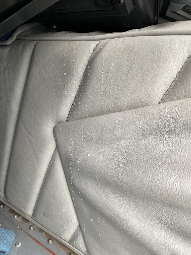

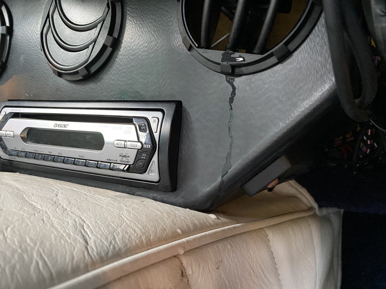

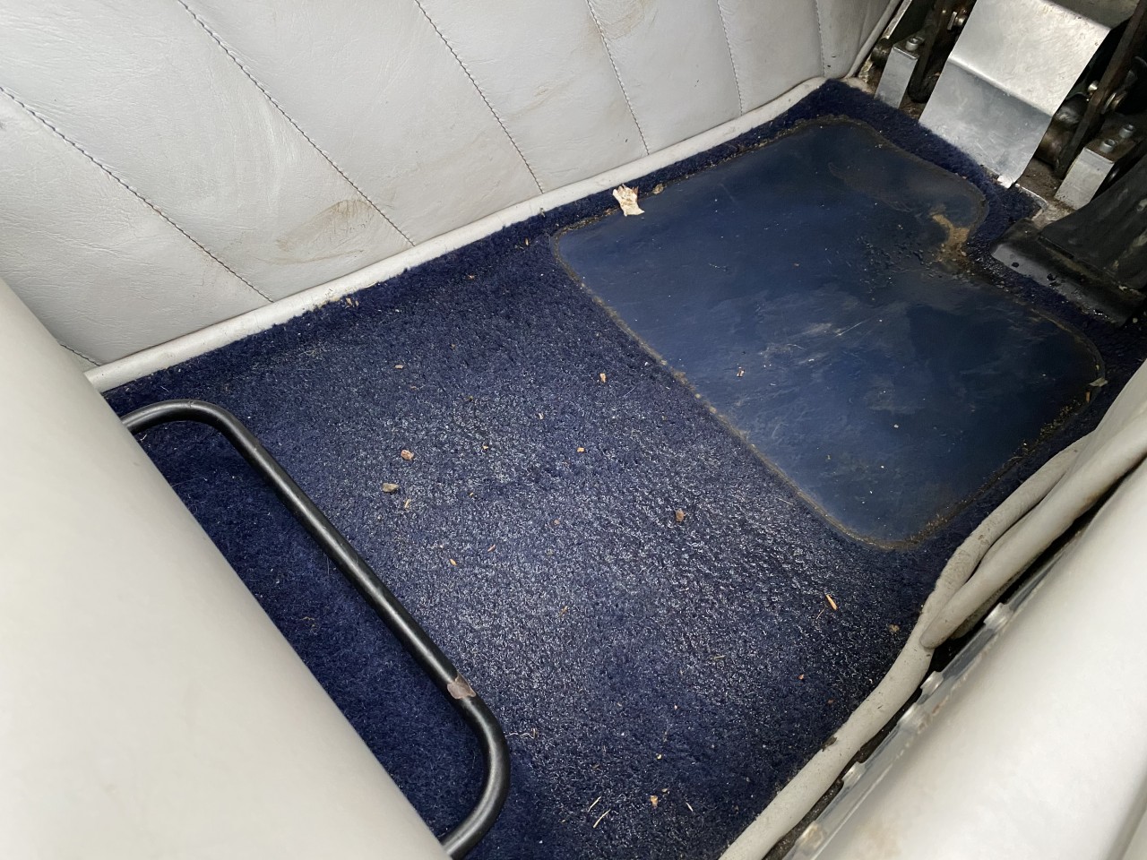

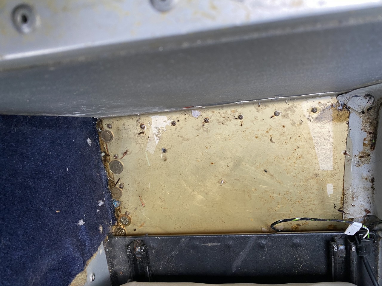

I wondered why my car smells like an old minge.
Left the car out with a shower cap over the hood as I know the hood leaks but didn’t think that water would flood in from somewhere else.
Not sure this is the whole problem as it’s about 10mm deep throughout the inside floor area. But there’s water trailing out of the heater vents.
Is there a heater plenum drain blocked perhaps?

Viper. It's a totally crap design on such a great car,I t hink the sponge on top of the heater box absorbs the water straight through the vent and once saturated the drip is like leaving a tap on .Your vent may also be blocked, hope this helps.

Blow the leak, there's £1.70 under the seats!
The previous owners contribution towards the devastation
