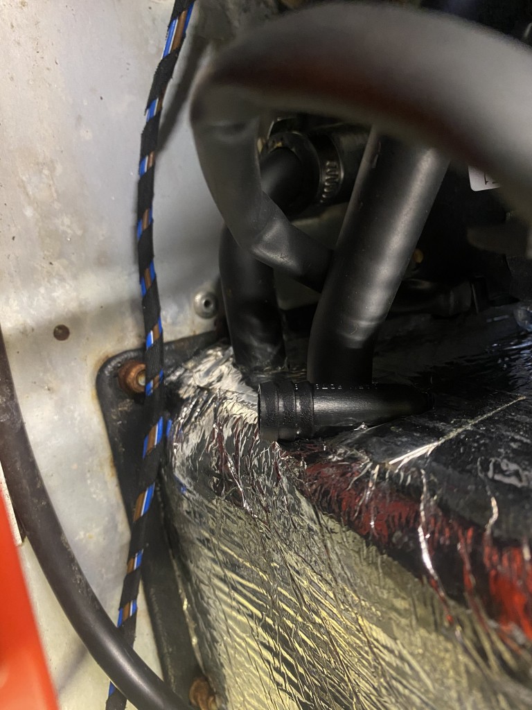

Pretty sure this little rascal could be the drain. There’s one each side. Seems a bit high though.

Water is coming in through the gasket between heater box and bulkhead ffs.
For me that is a major job. Not one I’m prepared to do.
