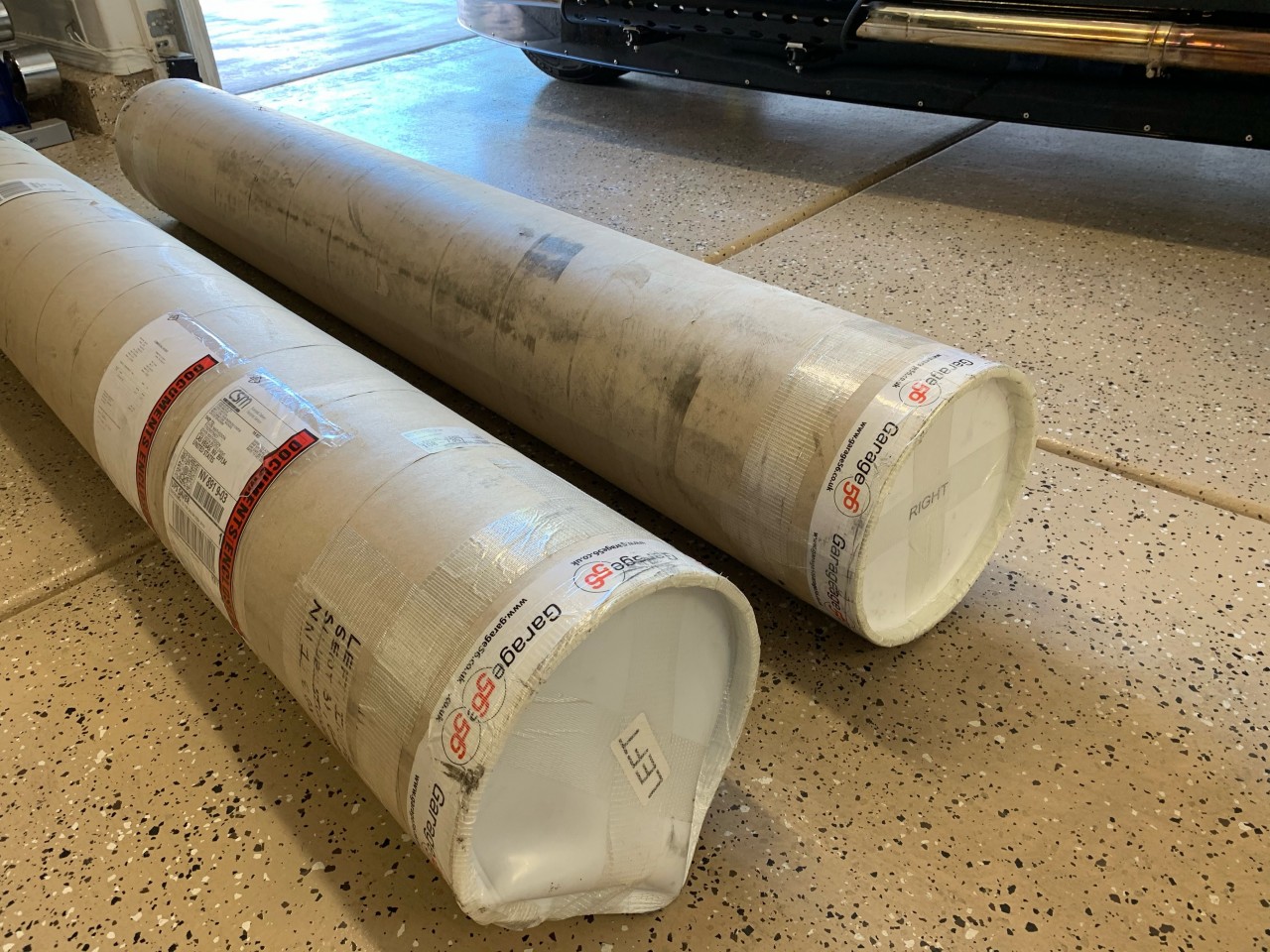

Thanks for all the tips here. I’ve just ordered my Garage 56 pipes based on all your comments, and some stainless bars to reinforce them. Already got the Stealth air intake, must have been one of the last ones! Excited to see how much better it drives.
Obie - is your front mount angled onto the existing bolt?

Surprisingly fast delivery from the UK. Now I need to find someone to powder coat the shields in black - is anyone aware of any potential pitfalls in having this done?
