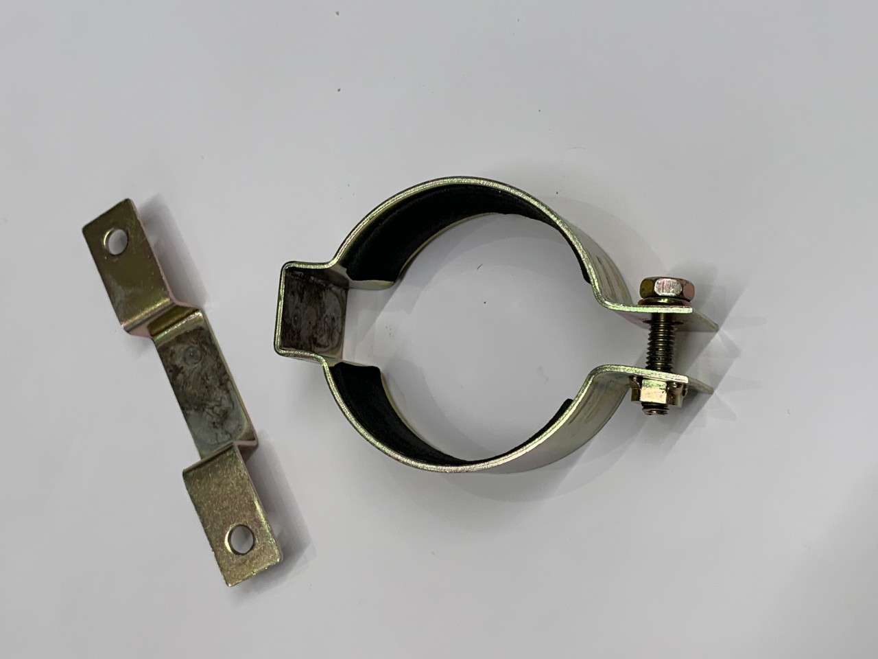

Obie - and JohnMat - you were right! My initial anger made me see things that are not. My support is broken, that's not good news. But fortunately the two pieces were originally welded by the internal side / face, so when the weld spots (two tiny sparks) broke - I guess that the vibrations were too much for a couple of fragile tiny welding spots - the part holding the filter remained hanging from the Ω-shaped bracket that is screwed behind the backrest. Unfortunate to have the piece broken, fortunate design. Otherwise the filter would have fall on the drive belt just by the shock absorber. Could have be a disaster.

Can you use those two bolts just below the filter to mount two padded/cushioned clamps to hold the filter?
Clamps like this, although this is a filter setup from Morgan Custom the clamps are what I had in mind.

Stephen, I guess this is part of Emil's fuel installation, isn't it? Looks neat.
Thanks for sharing your ideas. They're always welcome. And when it comes from you, knowing you're really skilled, I pay much attention to them.
Your proposal sounds pretty good. I'll go to the hardware store right now. I'll see if I can find solid clamps with the correct diameter. But I believe it's going to be easier for me to drill a couple of small holes and put nice SS304 bolts and lock nuts than finding good solid clamps with the correct size.
