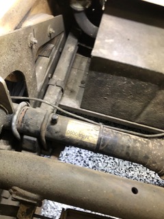

So checked a few items on the list:
1.Rear suspension brackets all good
2.Axle U-bolts another story:
-Right side outer U-bolt is bent outwards
-Also noted that the thread through nut of all four U-bolts was different with several not actually clearing the nut top at all!! (normal convention looks for at least 3 threads clear or past the nut top)

Here are the photos. I'm no expert but that doesn't look good.

The article is perfect, also like the nut change recommended i.e. Stover nuts as Nylocs are good but not for this type of application. Next need to find where I can get better quality U-bolts from.

Brief update.
Whoever suggested “check all fasteners” was spot on. Found front prop-shaft bolts loose hence the hollow clunk sound when load taken an or off the drive train in first or second gears, now sorted. In fact found lots of loose bolts, all tight now.
Did find a bent axle u-bolt hence replaced and also put anti-tramp plate the right way around. Previous one was upside down in an attempt (I think) to avoid interference with the floor/angle section at the back of the bulk head, so cut small section of angle iron away and refitted correctly.
Cleaned springs and applied a lot of chain lube, so far seems to have worked well.
