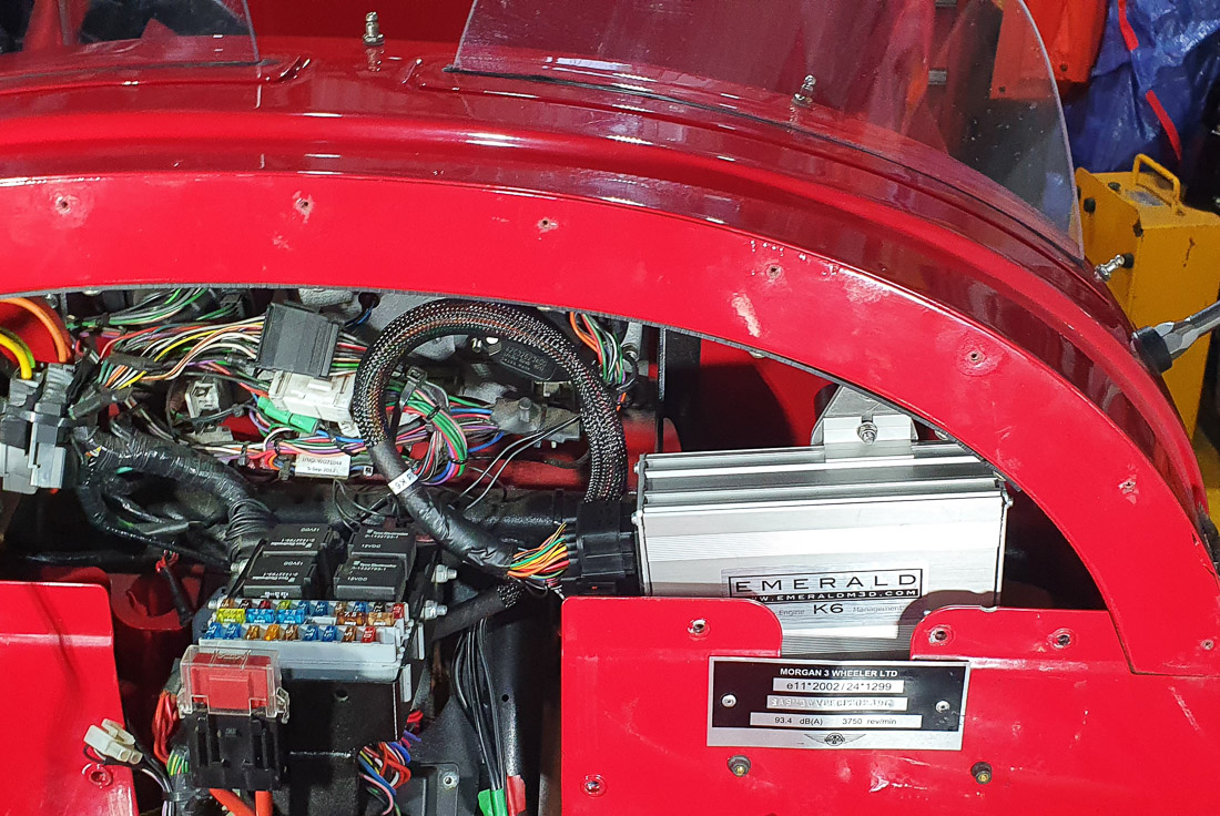

Funnily enough I'm just back up from my garage...
IMHO #669827 29/10/20 05:38 PM
Joined: Feb 2019
Posts: 3,857
Joined: Feb 2019
Posts: 3,857
What is that ECU??????
RedThree #669835 29/10/20 05:52 PM
Joined: Jun 2012
Posts: 2,242
Likes: 72
Joined: Jun 2012
Posts: 2,242
Likes: 72
I am guessing you have been in contact with G56 Calum????
planenut #669845 29/10/20 06:21 PM
Posts: 2,822
Likes: 155
Posts: 2,822
Likes: 155
Certainly have...they've changed over to the Emerald K6 ECU recently and I've got one of (or the actual) first production one. Initially they had a bit of a cock up over the wiring of the production loom adapter which stopped it from firing up but that is sorted out now, it fired up no problem this afternoon with a revised adapter but the rain has been tipping down so I haven't been able to get out and see what it is really like. Did drive it gently for a few miles on the standard ECU at the start of the week to get its MOT done and it ran fine, a lot smoother at lower revs than with the standard cams but I wasn't keen on driving it properly without an appropriate map.
