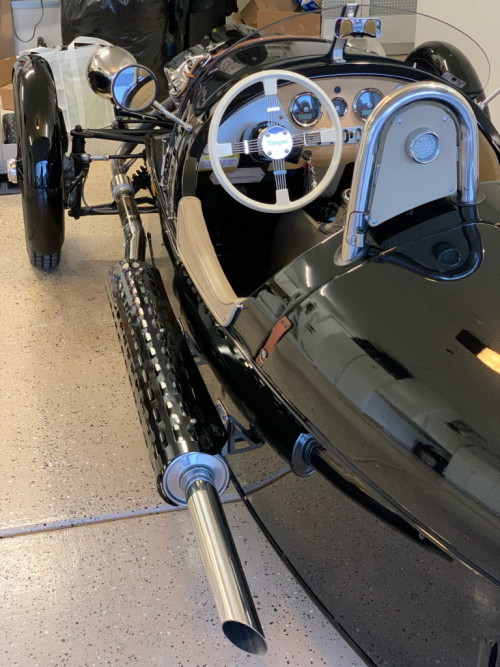

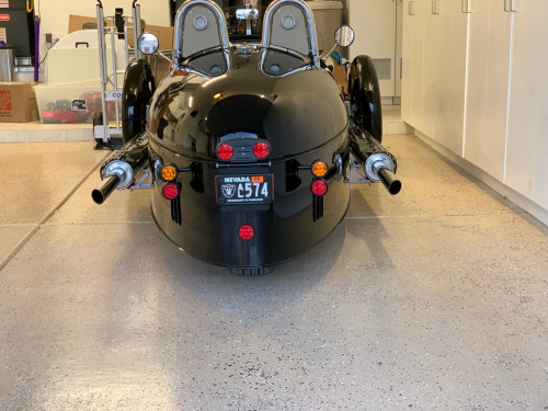

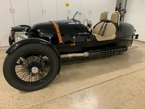

Finally got the time to fit my G56 exhausts this week, and now I wish I had done it sooner. As soon as I started the car and heard them, I couldn't stop smiling. Just love the new exhaust note, so much deeper and softer at idle, and a lovely bass snarl when you press the loud pedal. The way the throttle responds is much more satisfying too. Happy.
They look like weapons from the back of the car to my eye.

Nice!

Looks good. Any issues with install or did they go in very easily?

It is an easy install, if time consuming, as you have to pull the cockpit apart. Hardest part was pulling the old exhaust off. Strap wrenches are your friend.
I took the opportunity to clean and condition all the leather pieces while I had them out.

The braces for the rear mount suggested by someone recently are a good idea for the G56 exhausts to limit flexing of the bodywork and popping of rivets.
The G56 exhausts do sound great!

Great job! 👍

Thanks for the photographs
