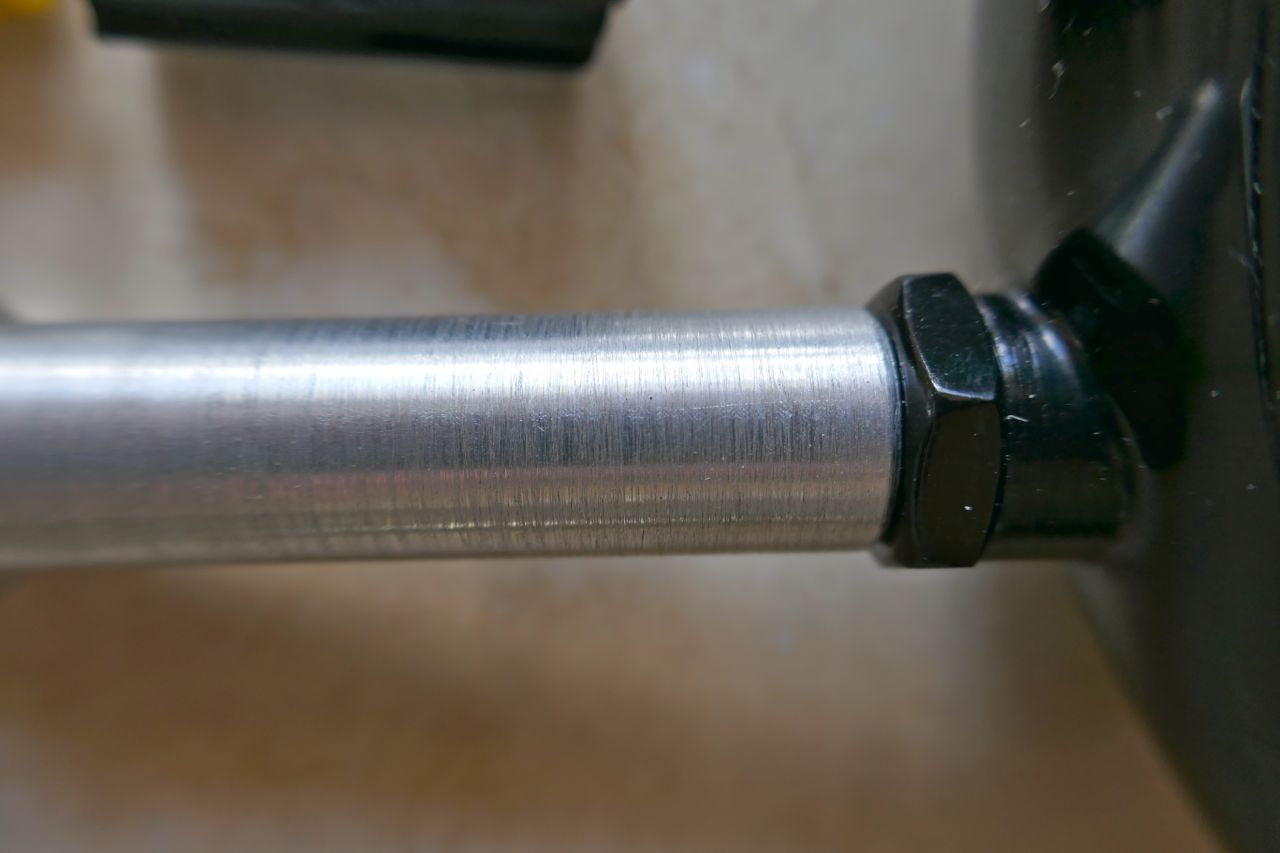

Richard is correct. I ordered those part numbers a while ago and received the following:
I found the finish on the aluminium upstand to be poor so this will require refinishing & polishing before fitting.
I haven't got around to fitting it yet, partly because it goes against the grain to cut a 12mm hole in the bodywork. shocked2 Also, my car is a 2012 model so will almost certainly not have the necessary electrical connector in the wiring loom. Not a big problem I guess but another reason to put the project on the back burner for now!
By the way, in 2018 I paid Uncle Melvyn £38.31 for the lamp (U340032) and £8.67 for the pedestal (T400037). Both prices exclude VAT & delivery.
