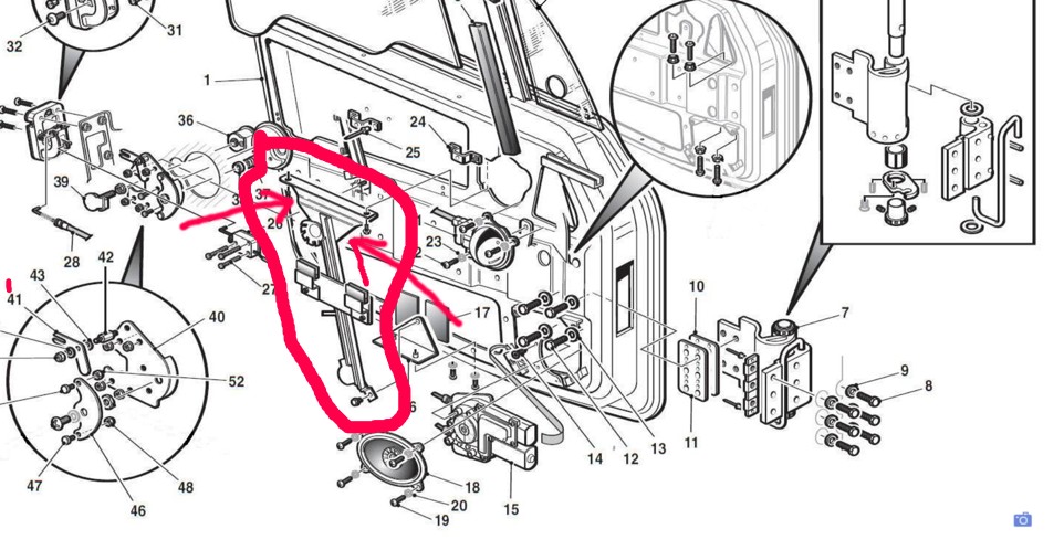

If I recall right it was this one (the cable should be where arrows are)
Borghi (Morgan dealer/importer for Italy) took care of everything. But it was not that long. Fixed in one or two weeks.
For sure it's coming from some other car and I can bet that being able to find the original source would be much cheaper.
