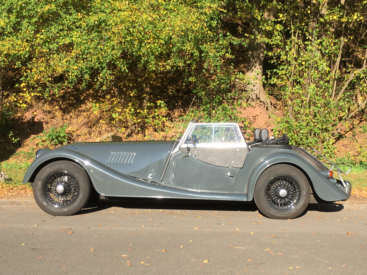

I have several things to do in winter, new hard chrome plated kingpins, new rear brakes, new rear shock absorbers just to name a few. I will definitely test it to remove the lowering blocks. On the Gomog page about the lowering blocks it is described that the geometry is better without lowering blocks and also the stability of the lateral guidance of the spring. And of course you have more suspension travel. On the picture (the grey Morgan) you can see my approx. 3 years old 4 seated leaf springs.
The car hangs down in the back.
The blue car, pictures from the net, looks right for me (regardless if she has lowering blocks or not). The black one is a bit high in the back. But both of them look more harmonious in the total addiction than my grey one. Another benefit of the 4 leaf springs: The car accelerates more directly. In comparison, you could feel with the standard spring that it had bent more before the car accelerated.

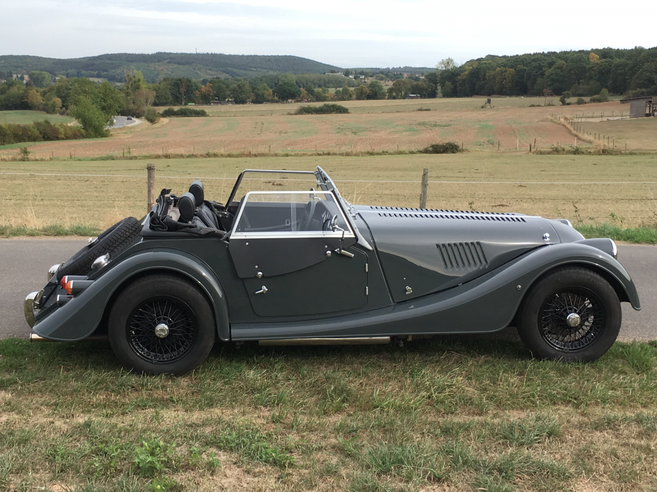

Here is a picture of my P4 SS from 2013, the last in the row. with an enlarged section. The car always looked very good. So I hope my 4/4 looks similar without lowering blocks...especially since my springs sag a bit she should not be too much lifted up.
if it doesn't look good, i can undo it or look for other springs that are less bent to get the optical effect
In any case I will report if the riding characteristics improve (they are not that bad...but the bouncing and winding of the springs is annoying). Unfortunately I don't have time for this before Christmas to do this measure.

I would think the leaf springs have sagged. This photo below is from September 2018 and the space to the tyre is larger although the photo was taken more from above. In both pictures, the new one in the post above and this one from 2018, the car stood more or oess straight. Now the sagging would even suit it if I tried it without lowering blocks. At least the spring rate doesn't change when the spring sags. So it remains fully functional.
