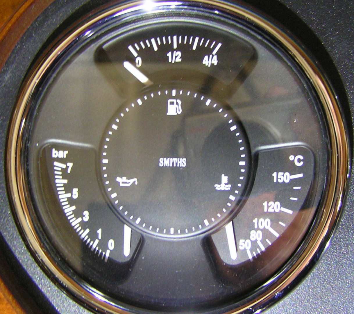

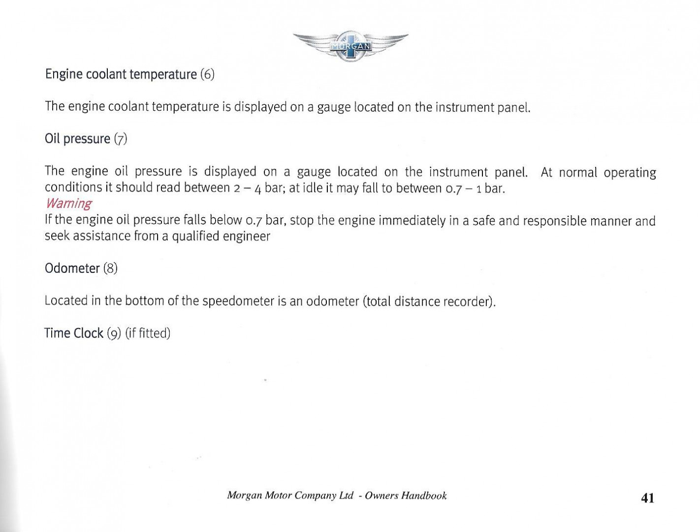

Many thanks for that helpful piece of physics. Also for the other experiences shared in this thread. I did finally locate some figures on p41 of the Manual, hidden-away in "Instruments" rather than engine characteristics. So it looks like we are all OK. But do any Morgans actually have an oil pressure as high as 7bar ? If not then why fit such a gauge, which means that the critical measurement as the needle drops from 1bar to 0.7bar is an arc about 1mm long !

Faults can cause over high oil pressure on engines .... stuck pressure relief valve, blockage of oilways etc .... and that's not good either ..... so I guess knowing when it's too high is a valid diagnostic function of the gauge as well as the more normal too low indication.
Posts: 8,664
Likes: 408
Posts: 8,664
Likes: 408
The cynical side of me suggests it was the only pressure range now available in that series of Smiths triple gauge.

I wonder if it's a 'symmetry' kind of thing? Although mine is a lot older - when under normal running, the oil pressure needle is pretty central, the ammeter needle is central and the water temp needle is central.
If standard running oil pressure for yours in 2-4 bar, again, the needle would be 'central -ish' at just over 3 bar.

And in racing and flying they would sometimes turn the gauges so when everything was normal the needles were all vertical .... all it took was a quick flick of the eyes across the dash to spot any needle out of line that might need more attention .... probably overkill for a touring holiday in Yorkshire though 🙂
On first start up, my oil pressure is around 6 bar, maybe a little more. It'll occasionally dart up briefly to 8 bar till till it's fully warmed up. I just put that down to a morgan quirk.
