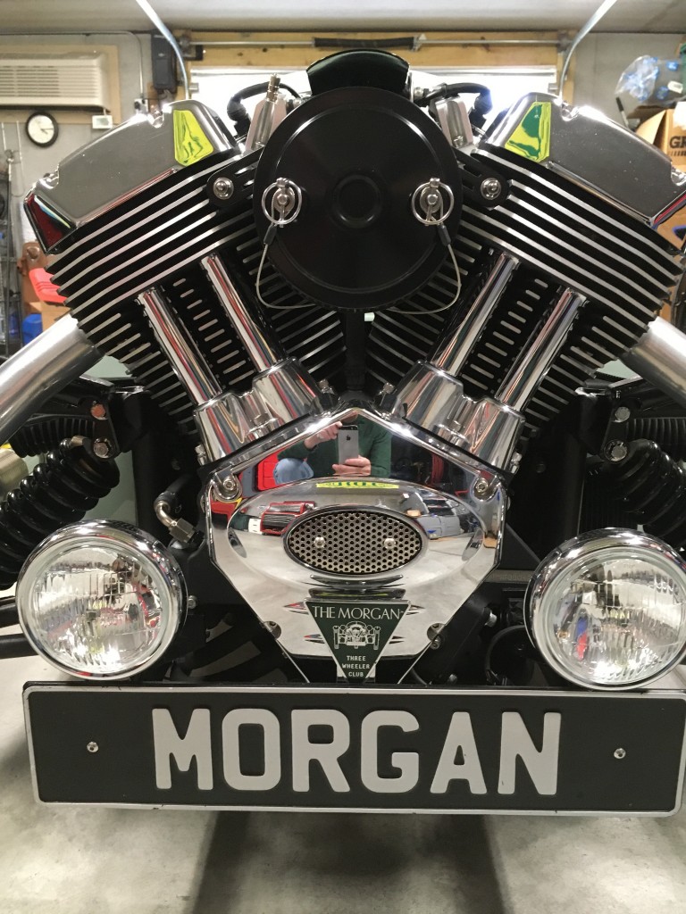

To eliminate the low loop in the vent line, I moved the vent line fitting from the low position used by MMC to the high position as used by some of the custom bike builders so the hose is always self draining.
Not a great picture, but you can see the vent line position with 90 degree fitting to the upper right of the left (in the photo) driving light.

Steve, was that the allen plug in the upper left side of the case that you used? Did you bore i ou to a larger size to get AN fitting on i?
