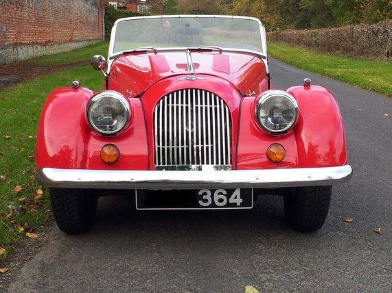

I totally agree on the 4/4 competition leaving the factory with the single twin choke Weber carb.
When I rebuilt my car, with the new tub from the factory, the original bonnet never fitted quite as well as I had hoped.
To rectify this, I took the car up to the factory to have a new bonnet made on the car.
As I always found the twin choke Weber with a performance filter quite a tight fit under the bonnet of the 2 seater, I had the factory move the louvre vents over slightly to help with clearance.
This may well be causing ructions among the purists, but as it was a bespoke modification by the skilled hands of the factory craftsmen, I don't feel too bad about it!

You have a hard time being a purist with Morgans, I don't think anyone knows what a pure one looks like!
I can't tell from your picture how many louvres you've got, the answer to that will definitely spark a debate.
