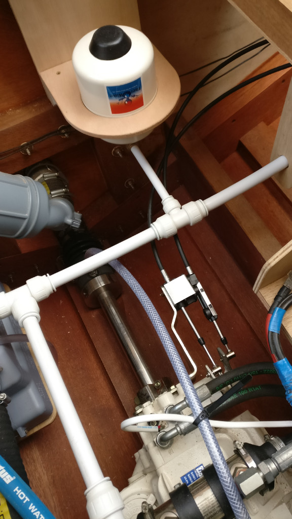

First up, expansion vessel for the domestic water, also the transmission and troll cables fitted and wire for neutral switch.

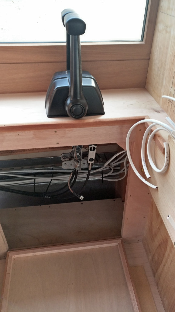

And at the control end.

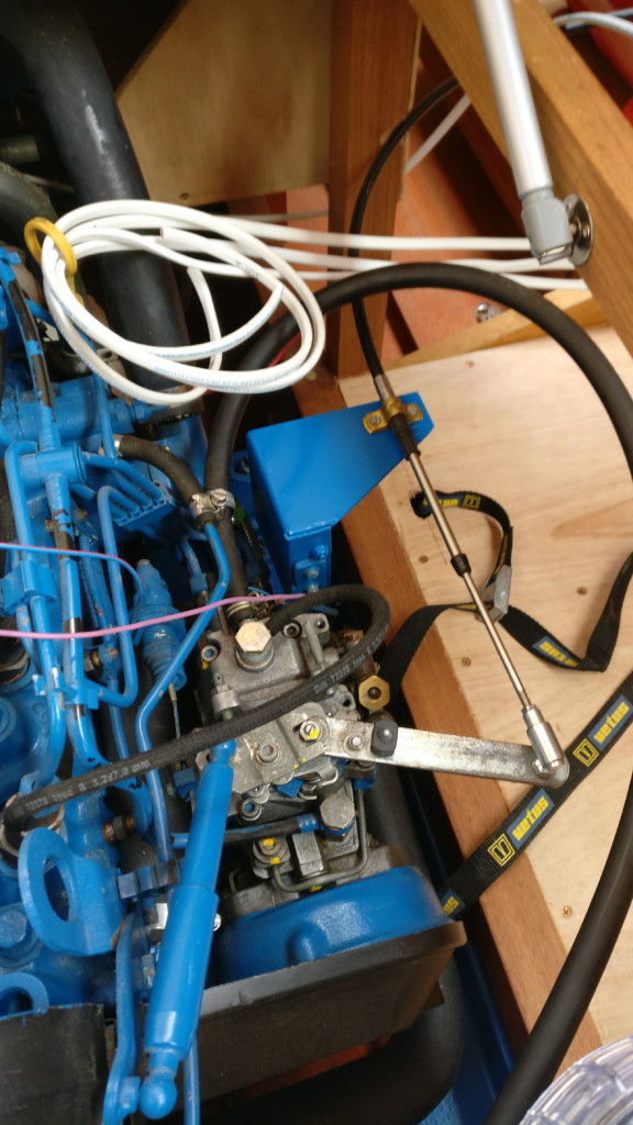

Didn't have full movement at the control for the throttle so extended the lever and then had to fabricate a new cable hold bracket. Full movement achieved now. Engine wiring roughed in as well.
Also had to remove fuel tank to get access to alternator, new higher output version being fitted.

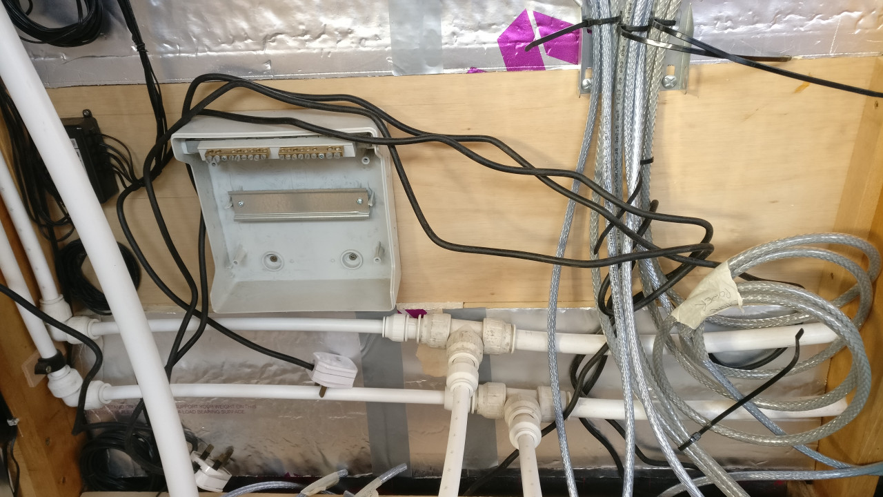

The current tangle of wires at the consumer unit, inverter will also be situated on this board.

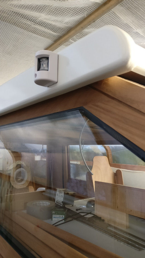

And the navigation lights fitted.

What's the nylon reinforced tube for, that looks like it's connected to the propshaft flange ?

Thanks Jon.
The clear reinforced pipe puts some engine cooling water into the vesconite bearing on the sterndrive, It then runs out at the prop.

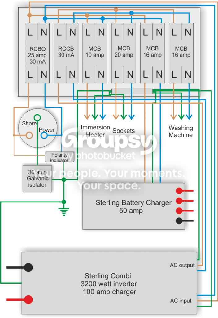

The consumer unit wiring reminds me of the AC fit on my boat Gordon.
That could come in handy, thanks Richard ๐Ÿ‘. Better not let Mrs D see it though, you had a washing machine, got more than enough to try and cram in as it is. Decided on putting in a Wallas combined diesel hob and heating system. Getting really good reports about them, anybody on here used or have any experience with this system?
