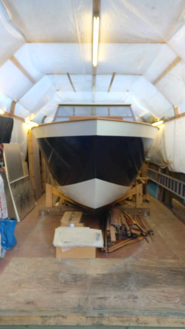

Another experiment in photo posting, this photo was taken yesterday, if this works I will add earlier pictures of the build and bore you all.
Fantastic, it worked, now I can add earlier pictures if there's any appetite for them out in TM land. I might even do it there's not.๐Ÿ˜‚

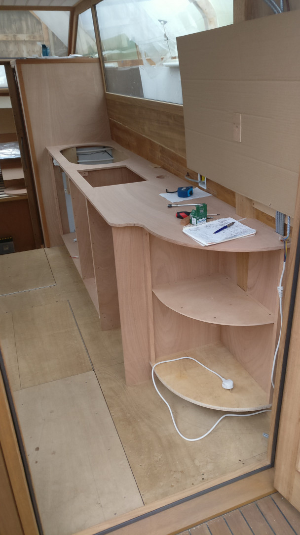

Not much visible progress since my last update apart from the galley units. I tested the plumbing last weekend and at least I know that boat holds IN water!!! My gamble to use the old water pump from the house didn't pay off as the seal between the motor shaft and pump body had dried out and this along with a leaking joint put around a gallon of water into the bilge. That pump is discontinued and no spares available so a new pump on order.
All this forced me to consider what bilge pumps to install and I've decided on two electric units and a manual as a backup. I've also bought the grey water pump but non of this makes for an interesting picture. I also noticed when filling the freshwater tanks that the third is slow to fill due to not having a vent. There is also the risk of sucking the tank in when emptying rapidly so some extra plumbing required there.
We've decided against hardwood flooring in this area as there are three hatches in the centre. Access will also be required in future for the fuel, fresh and grey water tanks. I've designed the units and seating to be easily removed and will fit carpet tiles for this reason. I'll now use the maple I have for the galley worktop and doors. Oh, and the piece of cardboard on the right is the TV๐Ÿ˜ƒ

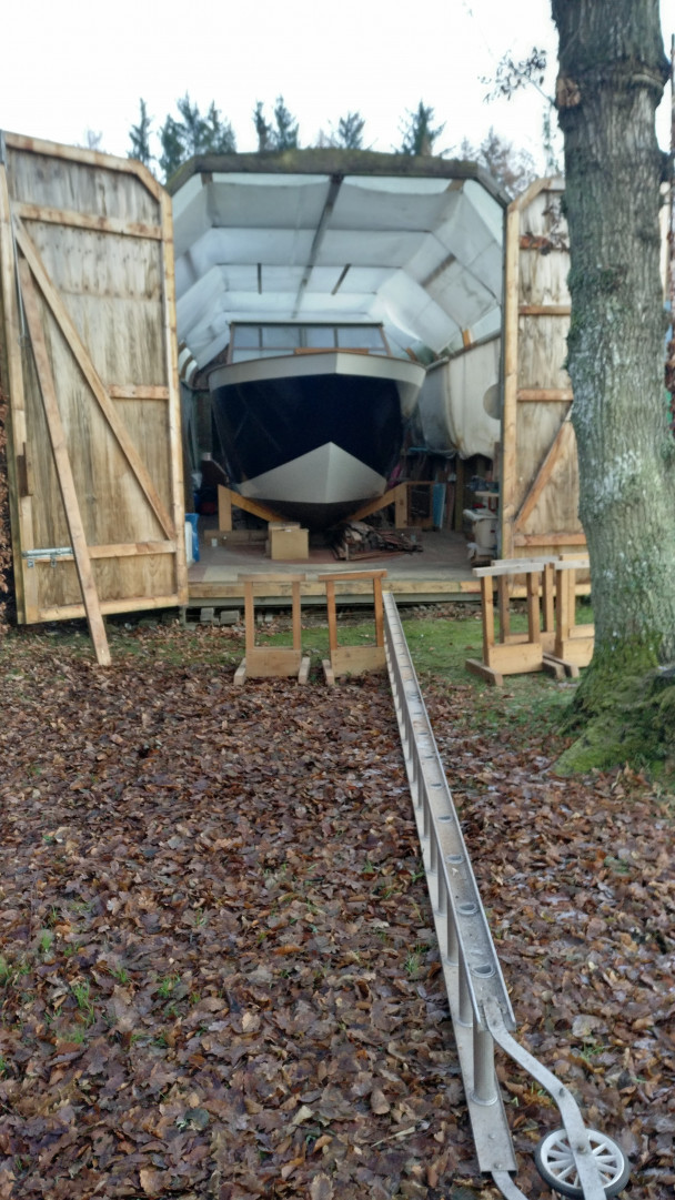

The mother of all clearouts has begun this weekend in preparation for moving the boat outside.
Making slow but steady progress on the internal fit out, mostly wiring and plumbing so nothing very photogenic.
Hopefully I'll have it moved by the end of February and I can reclaim the shed for work purposes.

Thanks for posting the pic Gordon, though that roof ladder spoils it a bit by bringing back memories of time spent on the roofs of this place around this time a year back..!!!
Your boat is looking great, I do like the colour scheme. Now that we have left the Winter Solstice behind us and are heading towards Spring, I am looking forward to reading of the launch date. I get the feeling there may be no bottle of bubbly smashed against that hull.. laugh2

George, the roof ladder hasn't seen as much action as it should have in the past year! Moss and lichen removal on the tiles seem to have taken a back seat lately. I find it really hard on my back being bent over and balancing on a 30mm bit of aluminium!

Keith, launch details are still under consideration. I've sourced a knackered boat trailer locally to get it out of the shed for final fit out. My neighbour has a tractor that I'm hoping to utilise for pulling power.
Mrs D works for a division of Macduff shipyards and they have helped me out with some machining jobs during the build. Current thinking is to hire a shipyard crane and a boat haulier to take it to (hopefully, still waiting) a mooring on the Caledonian canal. A nice gentle launch with a crane will give me time to check everything is watertight before taking the strops off๐Ÿ™‚
Economics has unfortunately ended the wooden boatbuilding industry as far as fishing goes. The yard still have skilled staff for repair and maintenance but they will dwindle away similar to the traditional building trade. By all accounts the yard build a very good steel boat though, but it's just not as romantic is it?
