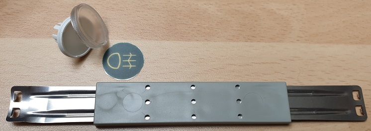

Originally Posted by The Austrian
Is this a simple operation or do I have to dismantle the whole dashboard?
You can just pull them out from the front with the EAO tool.. You can even print your own new graphics if you want....

Clever stuff that Roger, I've always popped them apart 'on the bench' out of the dash

Thank you, Roger!
That's exactly what I was looking for. happy3

You are welcome Hannes.
It’s a useful tool to have if only for gaining access to the lamps.
