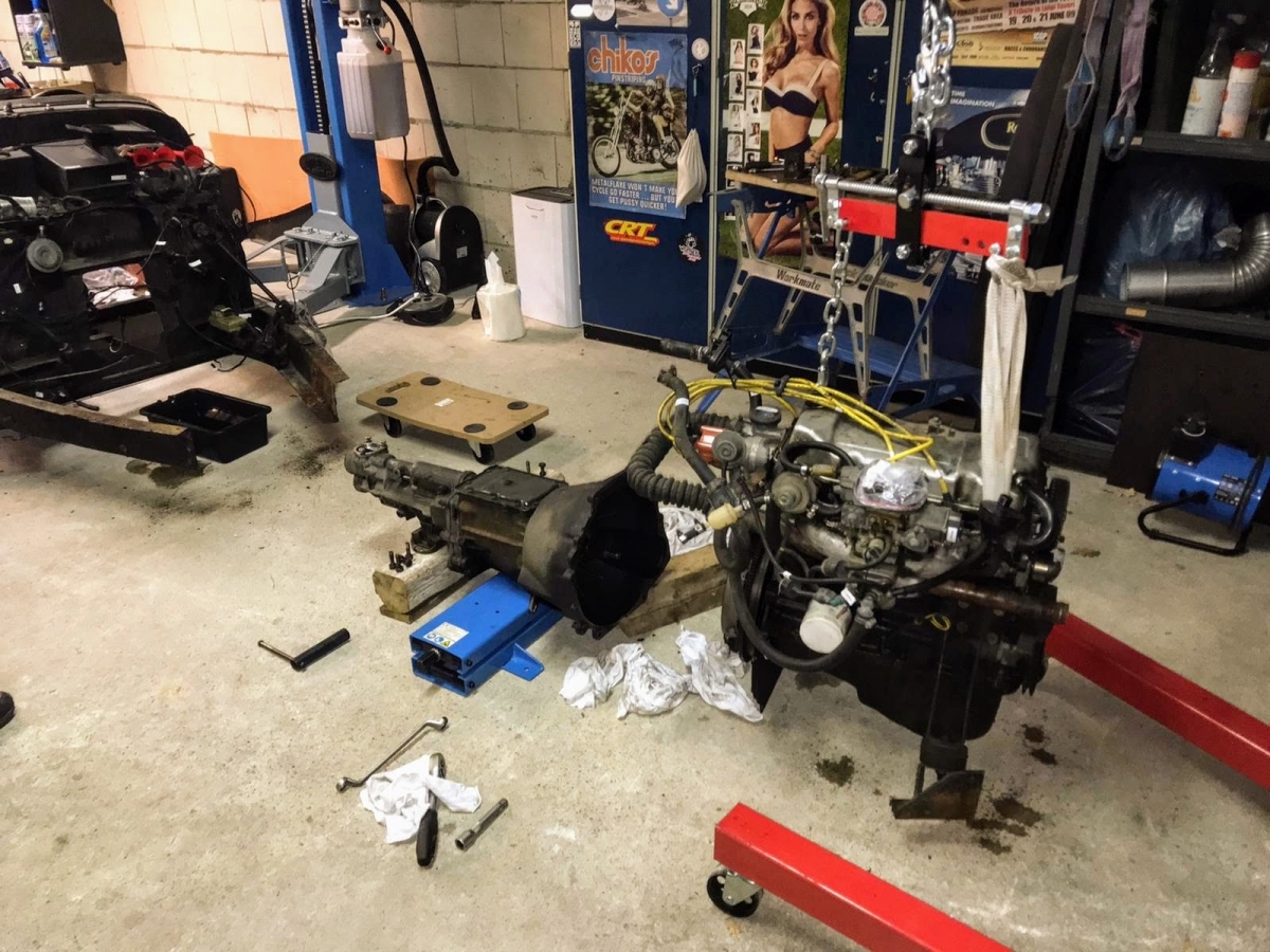

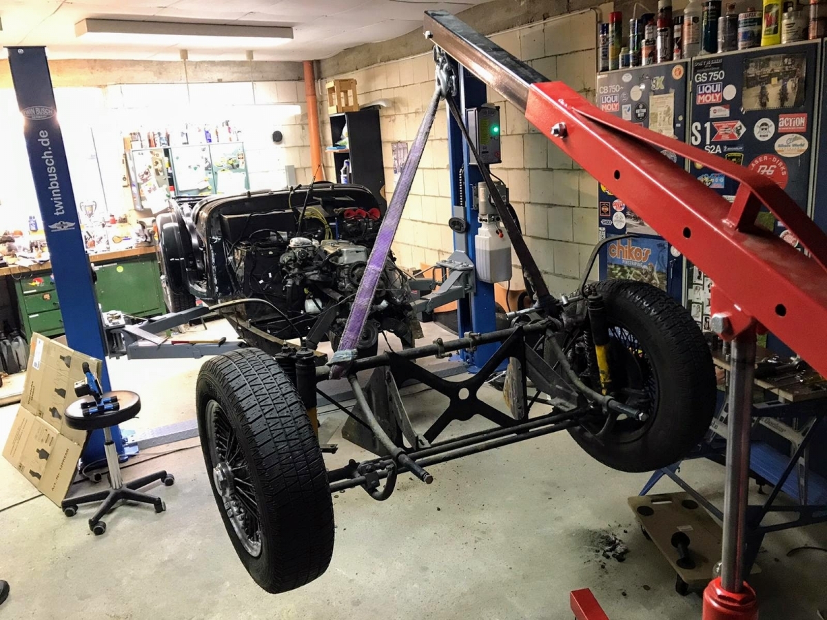

Christmas season has allowed to continue stripping of C6454:
It has been quite a straightforward task, nevertheless the term "screwing" has got a new meaning: Never seen before so many bolts and nuts fixed to a car....
I hope to lift off the bodywork within the next days.
Talk to you soon....
