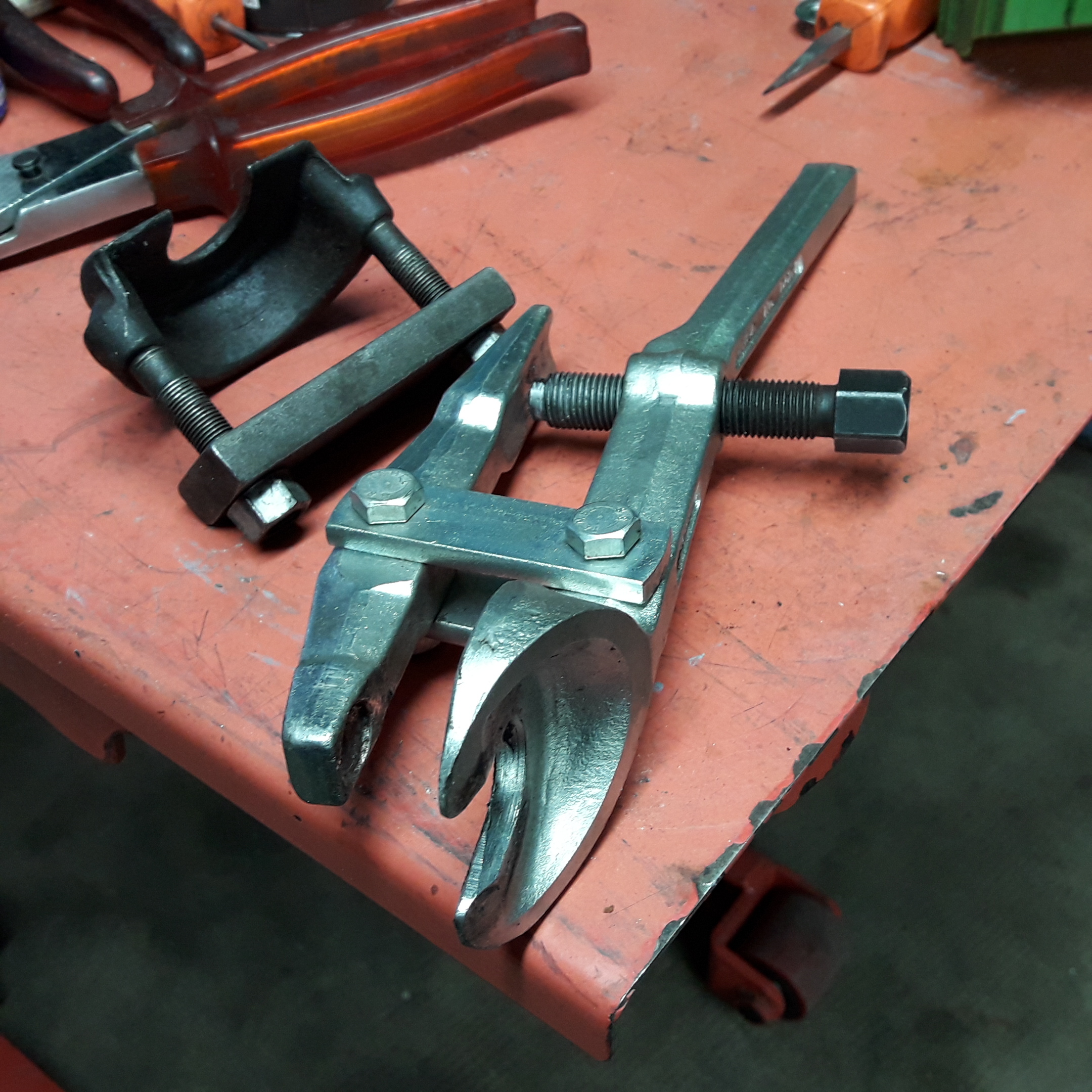

I have a multitude of extractors these two work well, especially the large one.
