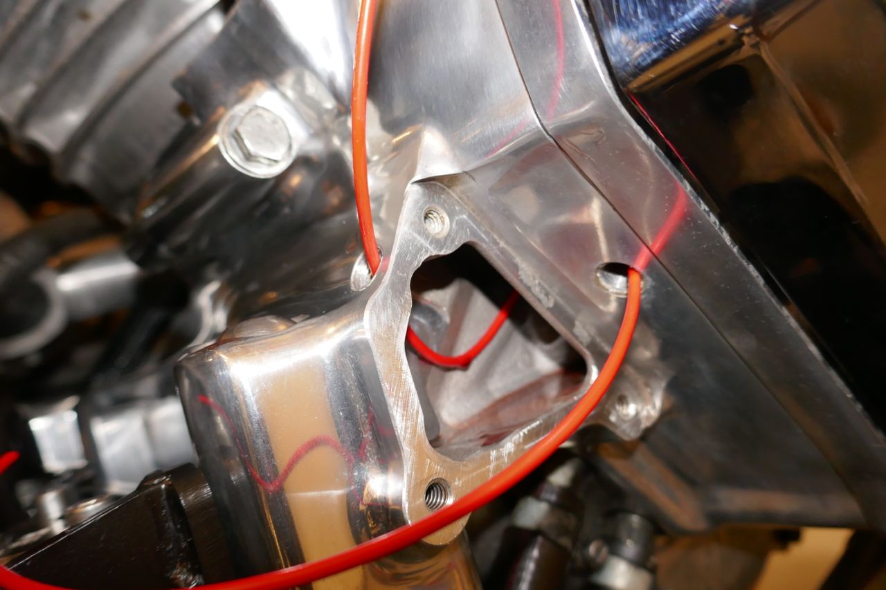

Just in case anyone is worried about the validity of doing this mod, this photo clearly demonstrates that both ports are effectively accessing the same chamber.

Are you in the magic circle by any chance Andy ?

I did think about taking the read valve cover off to have a look but you've saved me the bother., well done Andy!

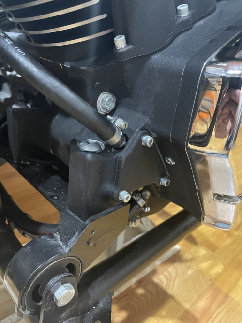

To relocate the fitting to the top as shown one must remove the existing plug. That can be stubborn because it is locttited in solidly. Apply heat to the plug and while hot then unscrew it.

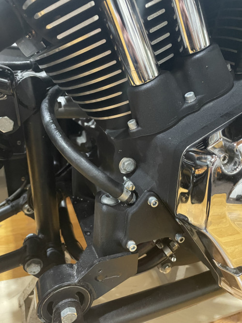

Here's mine I just completed. I just switched the original fittings and shortened the hose from the oil tank to ensure a consistent downward run.

Was it plugged?

Not plugged but definitely on its way, there was residue in the lowest part of the line. No cooler.
