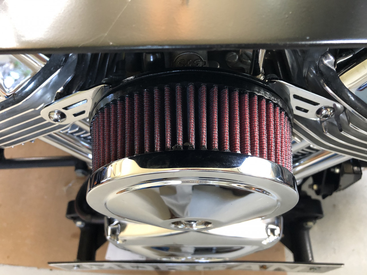

I looked on the S&S web page and it showed the 170-0200 air filter and mount out of stock. I call Morgan Motors of New England and they said they would order me one. It arrived in about a week. This was last month.
I also wanted the chrome muscle cover but the dealer said S&S no longer sells that cover. I called S&S and they also told me they could no longer get the parts to make the Chrome muscle cover. I went on ebay and found
two motorcycle dealers who both had over 12 of the chrome muscle covers and for less money than what S&S wanted when they had them.
Now I have to install the new airfilter and cover. Next comes cutting a hole in the baffles.

I also wanted to get the stealth air filter and chrome muscle cover. I called S&S and was told the back plates are back ordered
and they no longer make the muscle covers.
I called a Morgan dealer here in the states and they said they could still get me the back plate but not the muscle cover.
I found two ebay bike suppliers that both had a dozen of the chrome muscle covers new in the box for less money
than S&S wanted. It came new in S&S packaging.
