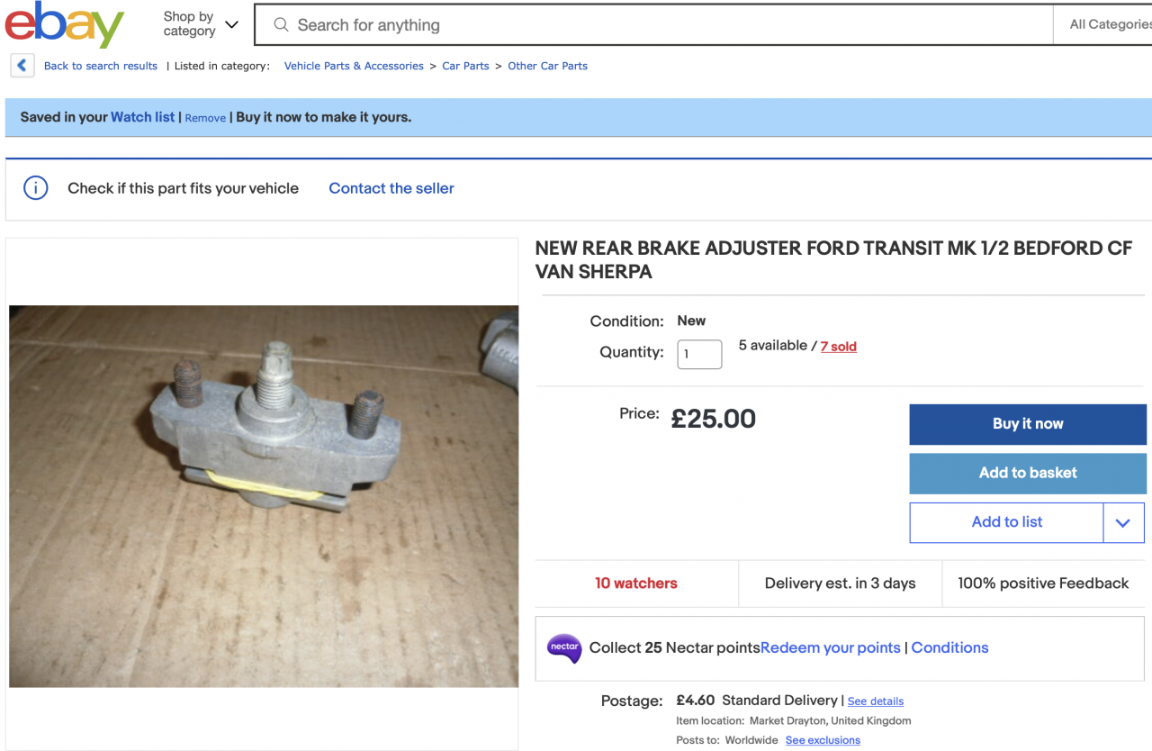

As has been discussed on these pages before, it would make life easier in the event that one has a seized/bound rear brake drum if there was a manual adjuster. I currently have the rear end stripped out for tyre & bearing change, and with plenty of time on my hands I reckoned now would be as good a time as any to investigate further.
The drum components are mainly Lockheed so it didn't take long to find something on eBay that looked about right.
Here it is compared to the standard fixed item.
As you can see it slips right in.
...and all looks very 'stock'.
I set up the adjuster so that the brake shoes are held the same distance apart as the standard fixed item. Just to be clear, I don't intend to use this as a regular adjuster because the standard automatic ratchet device works well most of the time. However, If my pads bind on the drum for some reason then it will now be a doddle to back off the adjuster to allow easy disassembly.

Originally Posted by Lance
I think you must have found the last one
Need to be creative with the search! Just found another one. He claims that he has five of them too, although they are a little more expensive than the one I bought.

Found a cheaper one if anyone's interested. eBay item No. 124589834979
