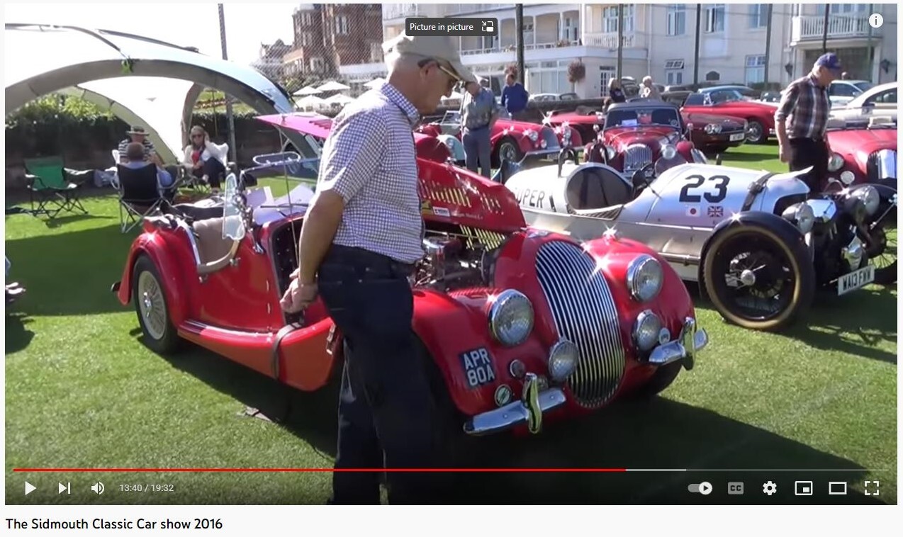

Just my opinion, but when I spotted that ad I thought it's a shame to have added the "front chin extension" as Ledgerwood describe it. Reminds me of the grille of a car I've seen at a number of shows and which is not to my taste (sorry if the owner is someone on here)....
