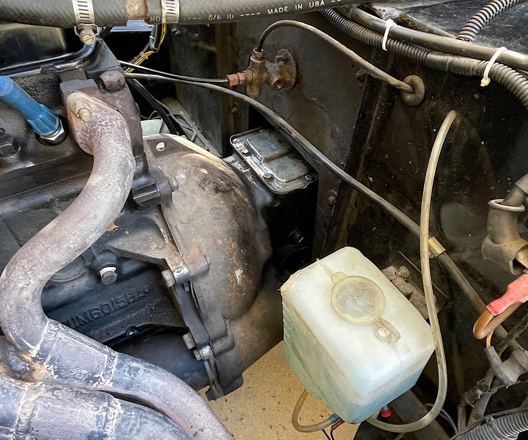

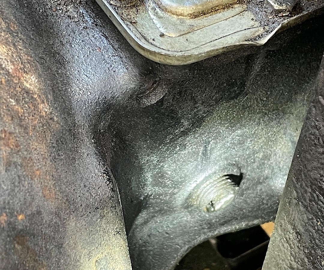

Gearbox oil check 2nd attempt at pics
Fingers crossed!
Yes!!! Success!!
Please cross reference these pics with the original text. Thx.

Yes that's the one. You will need a Syringe to draw out the old oil and replace with fresh. When i did mine i had to souce a extra foot of tubing to get to the bottom of the gearbox. Apparently some owners of Kent engine cars, on having the gear box rebuilt have had a drain plug installed.

On looking at your picture, my plug is further back into the cockpit area, just below the dash. I had the 5 speed conversion carried out about 15 years ago now. Best thing i ever did!
