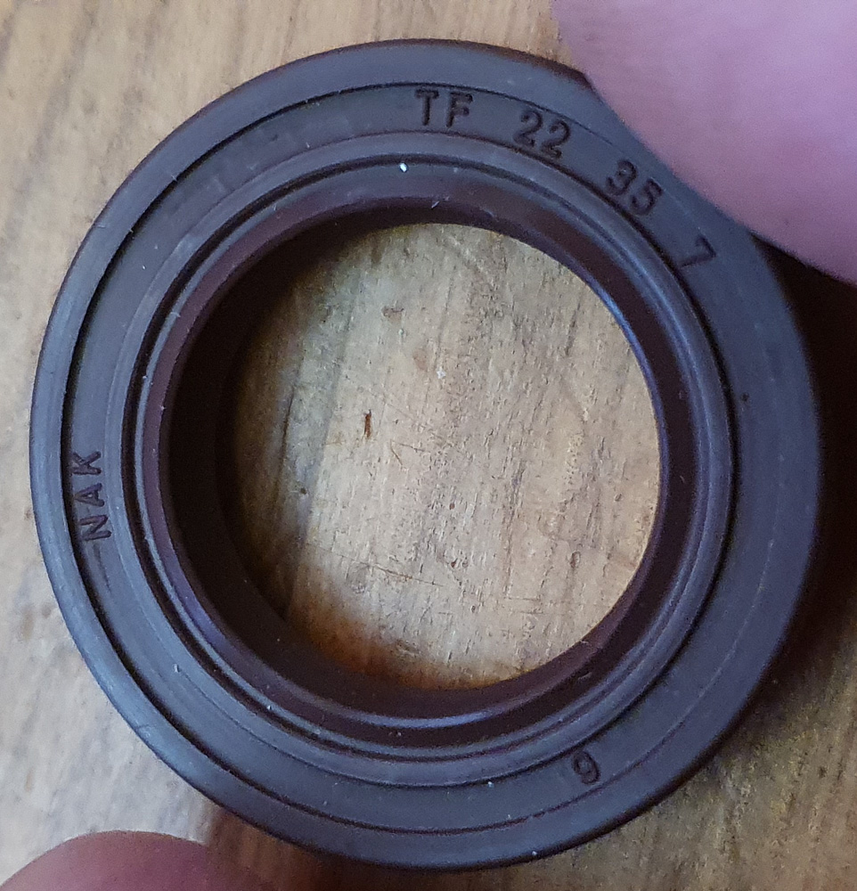

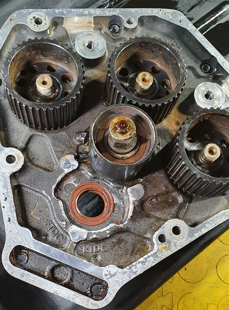

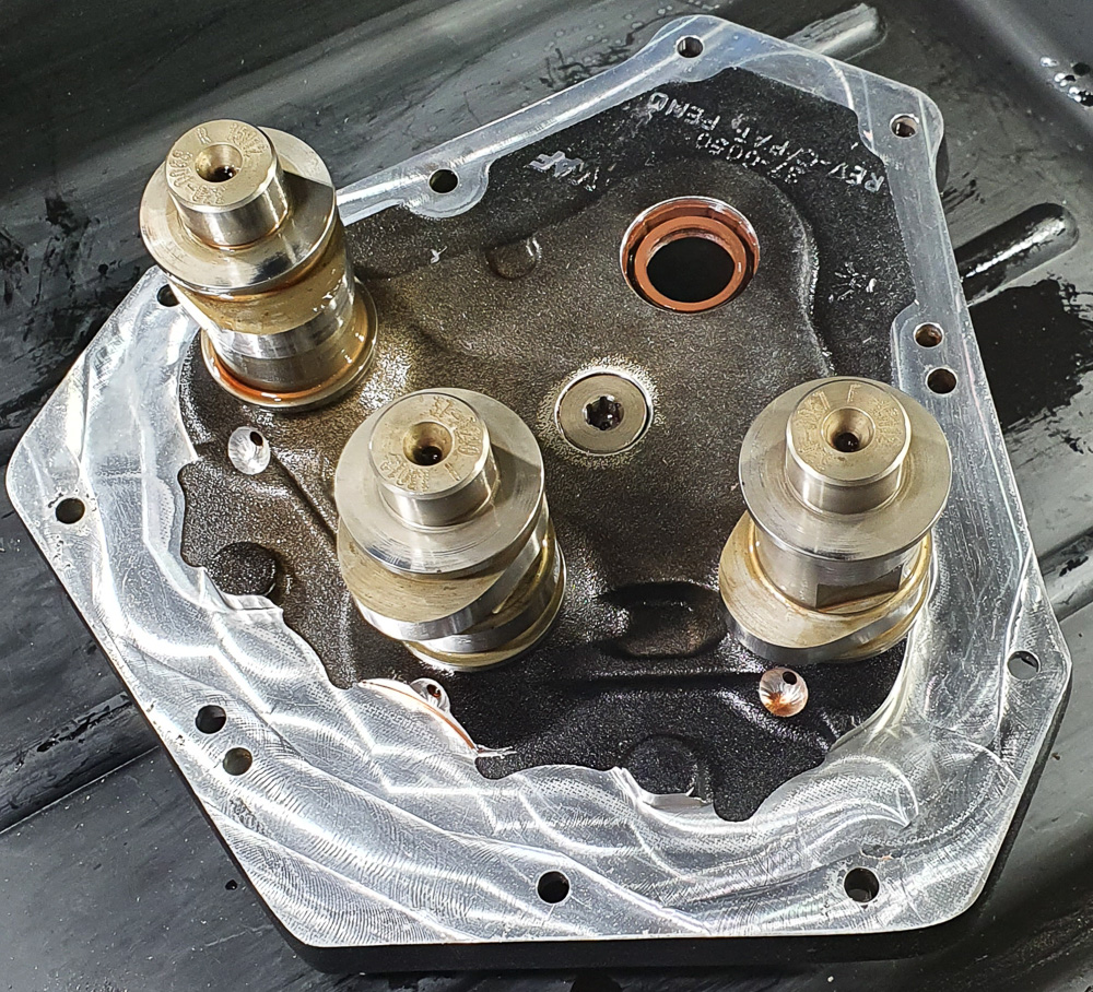

Think most things have been covered so, for information, here's some photos of the seal;
Pinion seal from the cam belt side of the carrier plate;
and from the inside of the plate;
and the new seal that went in;

Good photos Calum, as usual. Would you happen to have a part number and source for that seal? It does not look like the SKF Seal that came from S&S.
How did it workout? Was your leaking or did you replace it just because you were there?

My one had seeped for almost eight years...but never enough to be worth worrying about.
It's just a twin lip 22-35-7 and from memory is Viton though I stand to be corrected on that. Available from any decent bearing/seal supplier but do note that it is metric despite being in a US made engine.
Don't think the new one is leaking yet but it's probably just a matter of time!
