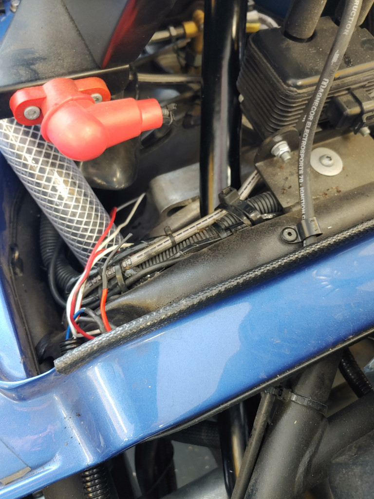

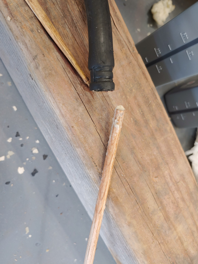

I relocated the line this weekend. Even though I drive to get the engine up to temp, you can see what was in the vent line

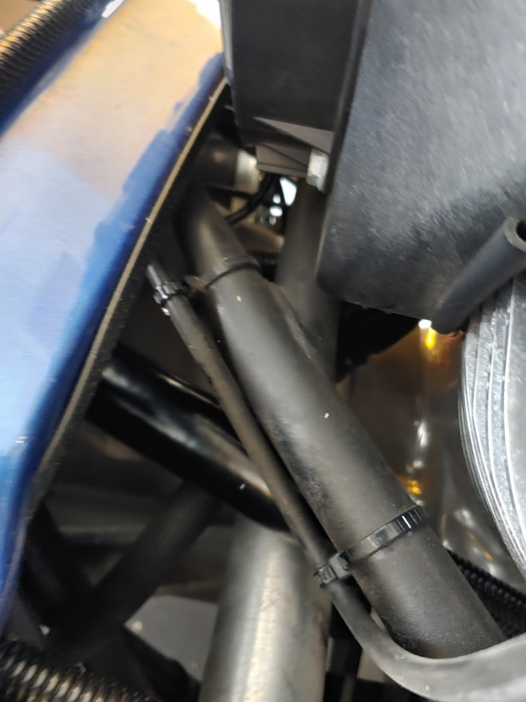

As the new line would cross over the transmission I slide it through a 7/ id hose to absorb the wear and tear. It is the shiny black hose. The clear braided hose covers the oil return hose to protect it as well

That dip in the line that MMC put there was a bad design. Your reroute and shielding should solve the problem.

yes there was a good 6 inches of line below the vent hole.... usually 6 inches would be a good thing grin2
