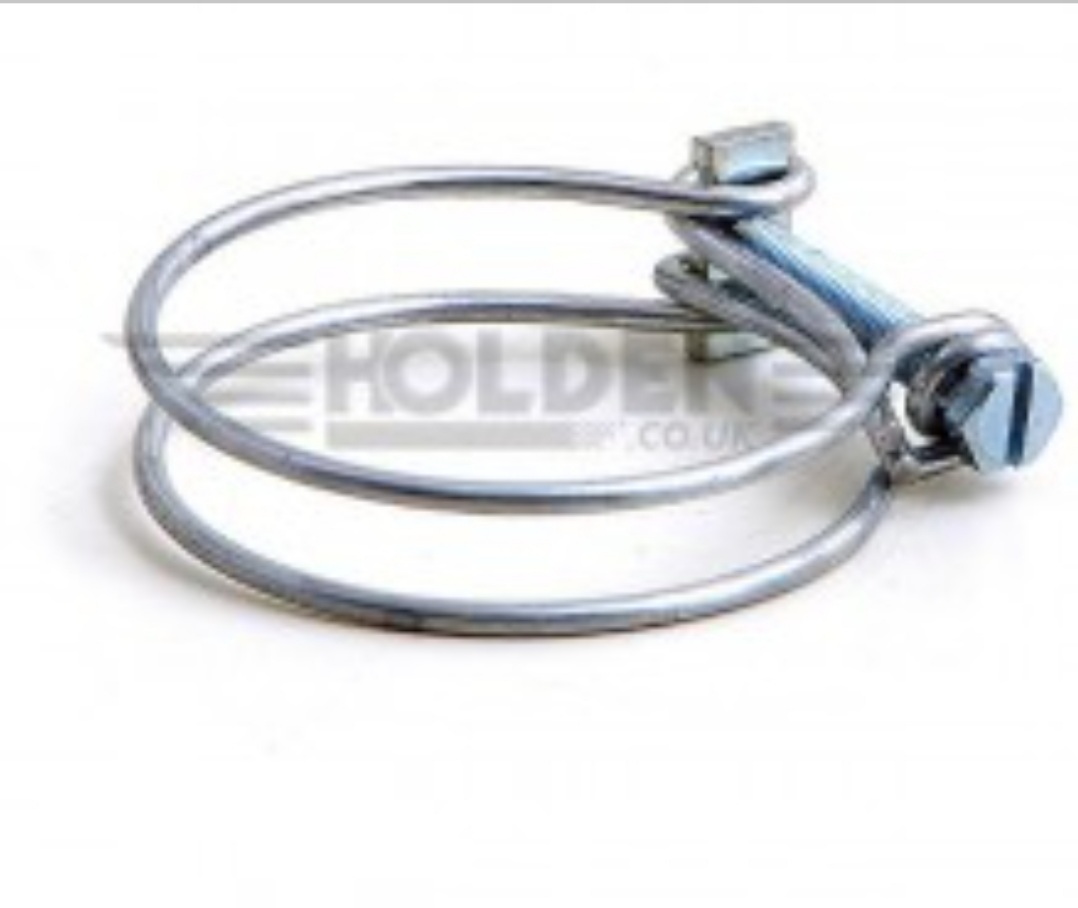

Tim ..... if you aren't wedded to the look of your hose clips, couldn't you use these ?..... also available in stainless .... they could be tightened with one wire each side of the 'olive' .... they have huge clamping force, and fixed like that would not pull off

If some 4/4 CVH owner doing a restore and running into a similar issue reads this thread in future: Go with the clamp that "Image" posted above. Stupid me had a mental "marriage" with the new wide stainless-steel clamps - the ones above would have worked fine I believe.
