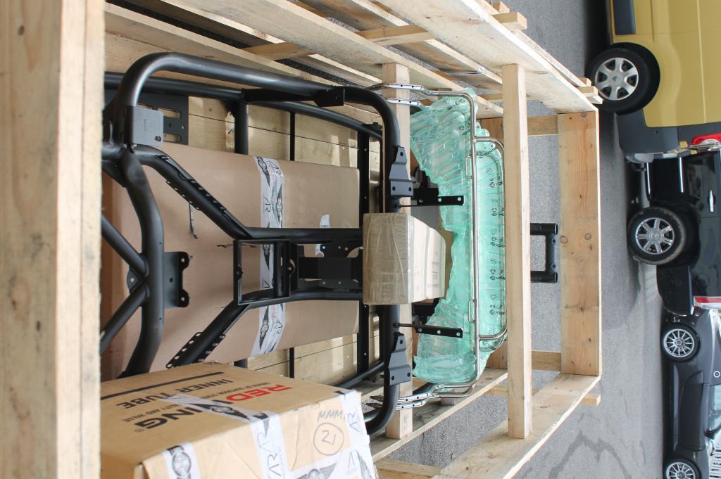

A friend of mine has a new châssis after an accident
Thé Mtw didnt looked damaged but when i had a look on it the front tube on the right side wasnt in the same plan
The insu rance expert confirm it
The new châssis arrived this week after an order taken a year before

A year to get a new chassis? Wow!!!
Joined: Jun 2010
Posts: 698
Toys for Boys
Toys for Boys
Joined: Jun 2010
Posts: 698
😱 A YEAR 😱
But you got two free luggage racks?!
