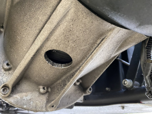

Trying to stay positive but today the following happened.
Driving normally, not hard
Went round a corner and .no drive, no garage
Clutch down, into gear, nothing. It's like it's in neutral. Jeez. Maybe M3W just ain't for me.
Shame.
And to cap it all, how the hell do you load a pic up on this site. Sorry to blow of steam but I want to enjoy my car.
[img]https://tm-img.com/album/zUSN[/img]

I know where you're coming from, not the most reliable of things unfortunately.
When you operate the starter does it turn over the engine as normal or just spin freely, if the later then probably the rubber Centa rollers have disintegrated.

There is a detailed set of instructions about how to post a photo on this forum in the "welcome" section. It sounds like your Centa rollers have broken up. Can you re-start the engine with the starter motor or does it just whirl over without turning the engine? If it just motors over without any engine cranking, they have failed completely. Total failure can happen if you ignore all the vibrations, noise and rubber smells and chunks of rubber roller on the floor.

Does sound like the Centa rollers. It is an engine out job to replace, would recommend the Phil Bleazey modification whilst it is out, as you can then replace the rollers at the side of the road if needed. Contact Phil as he can take the engine out and modify the Centa.
