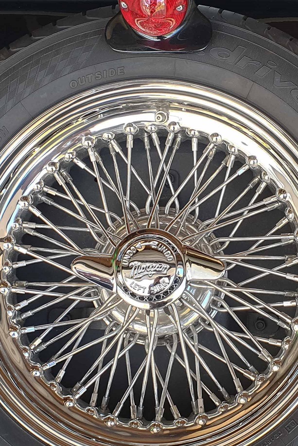

Great idea ,I just have to find a spare spinner .

Great solution. Like jimmyw I would love to get my hands on another two eared spinner.

Think I prefer mine as it is hide

Well spotted Mr.DW. The spare wheel is off the car at the moment, but I will remember next time thumbs
But… If you had one of these you could colour in the logo innocent
Roger
like this ?
I’ve had this spare spinner kicking around for ages along with a desire to somehow use it to replace the tap handle arrangement that clamps my spare.
So I gave it ago this week....
First find a suitable bolt. This Tee bolt was perfect.
Pre tack the bolt in position. Important to get it absolutely centralized and perfectly upright.
Acquire a few tubes of epoxy resin from the local pound shop.
Fill the cavity. Not the prettiest of potting but it did set really hard and glass like. I don’t think the bolt will be detaching any time soon hide
But if you do find a spare wheel laying by the side of the road it might just be mine laugh2
That really is a quality mod cheers
