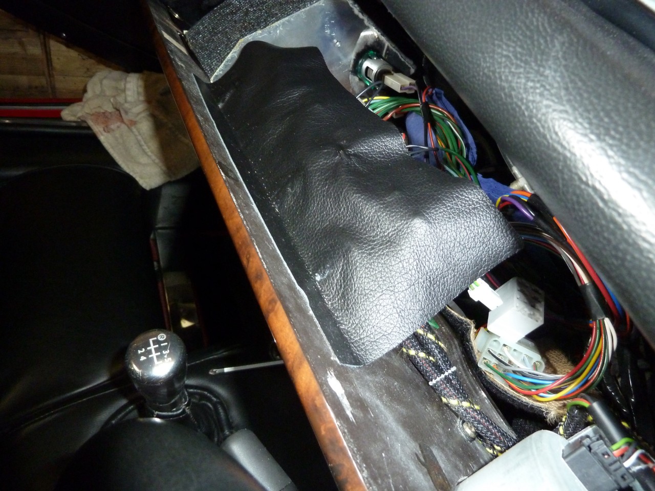

The windscreen washer tubing under the dash varies, but some cars have a very thin walled black plastic tube which is similar to a cable cover, and very floppy. At each end, to assist holding it in place is a thin ring of the same tube over the top. One of mine was missing. My tubing has never leaked but watching it, while squirting the screen shows that it spasms quite violently, and could easily detach itself. This image shows the original black tubes. From the pump to the T piece is a more conventional clear tube. The black leather in the foreground is a cover I added to keep water away from the instruments and circuit board. ![[Linked Image]](https://tm-img.com/images/2019/11/17/P1050419.jpg) This is the original tubing next to the aquarium tubing I sourced from e bay.The size is 3mm. You can see the extra rings at each end on the original tubes. ![[Linked Image]](https://tm-img.com/images/2019/11/17/P1050420.jpg) Here are the new tubes installed. I used the original T piece, although a new one came with the tubing. The original was a firmer fit. ![[Linked Image]](https://tm-img.com/images/2019/11/17/P1050421.jpg) The next image is a better view of the leather apron which covers the back of the instruments and circuit board. ![[Linked Image]](https://tm-img.com/images/2019/11/17/P1050422.jpg) Finally I tested the system and there were no leaks.

The leak deflector is a good idea, as I think the S1 switch panel electronics are NLA

I like the leather protection over the electric's, I had a issue a few months back while driving in the rain , my indicators started flashing (right one first and the left, then both started flashing people on the M1 must have thought I had gone mad, pulled in to the services and dried of the water behind the dash, before setting off again After talking to Chris Bailey at the NEC the last weekend I have a good idea where the water is coming from (job for over the winter) but will look at fitting a deflector asap Thanks for the idea Dave
