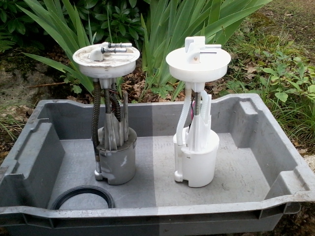

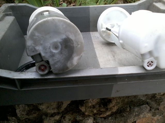

I ordered a complete pump to put in a spare Walbro, I will tell you if the connections. of gasoline are good.

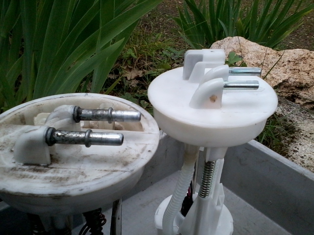

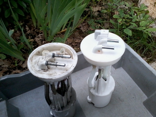

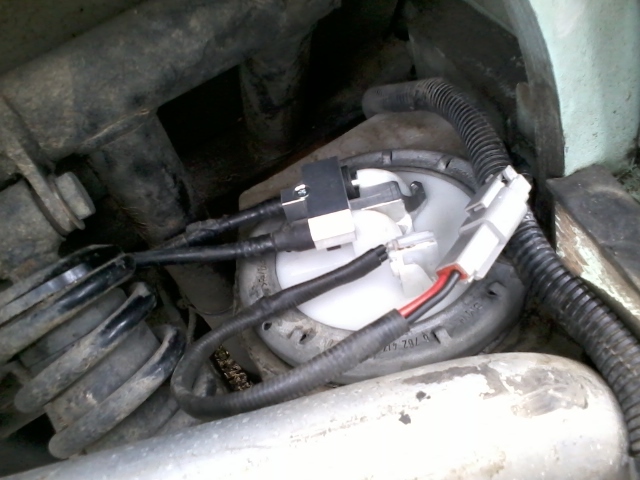

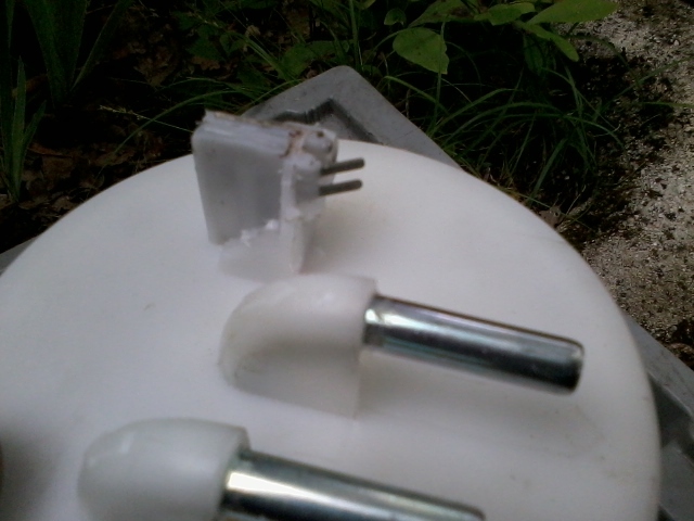

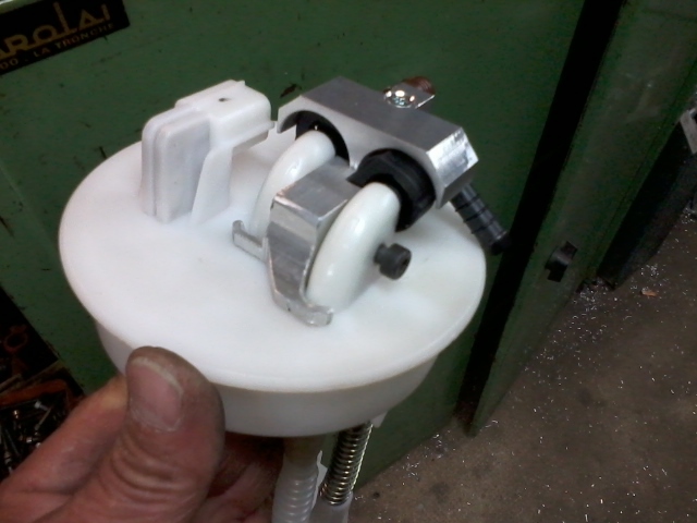

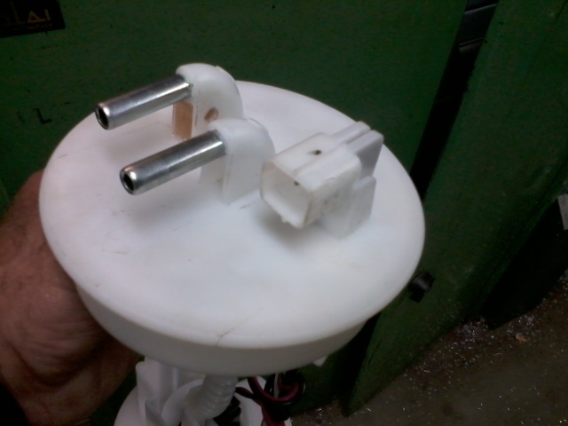

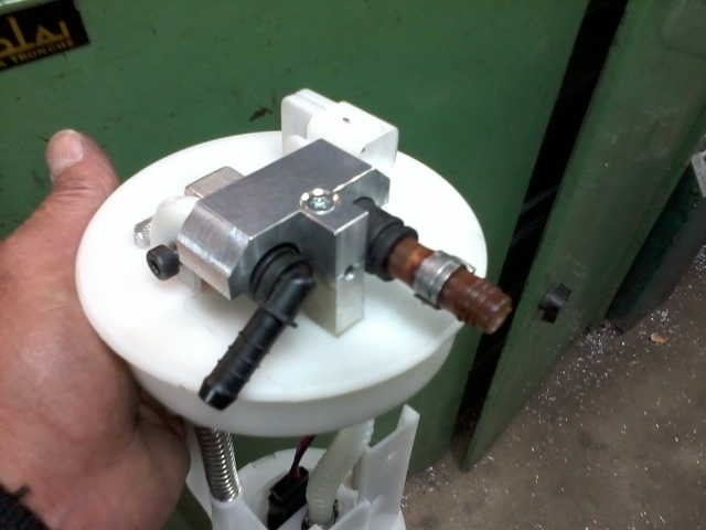

The complete fuel pump is not identical to the original for fixing the exterior fuel connections, so I made a metal part to re-seal the fuel connections, I replaced the pump with Walbro GSS 278 190lph it seems to me largely sufficient for the flow of gasoline and must consume less electric ampere.
the electrical connection remains econoseal amp.

Wow, that's different.
Found this on the web - they reckon it's off an early (1992 on) 4.0L V8 Land Rover Discovery.
Very neat adapter you've made. notworthy I wonder how the fuel pipes are attached in the Discovery?

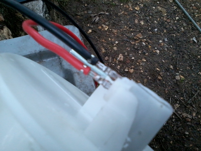

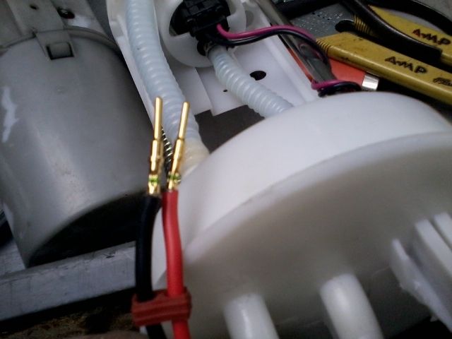

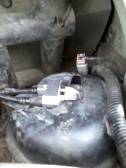

Electrical modification.
The fuel pump is much quieter than the 255 LPH and works very well despite the high fuel consumption.
