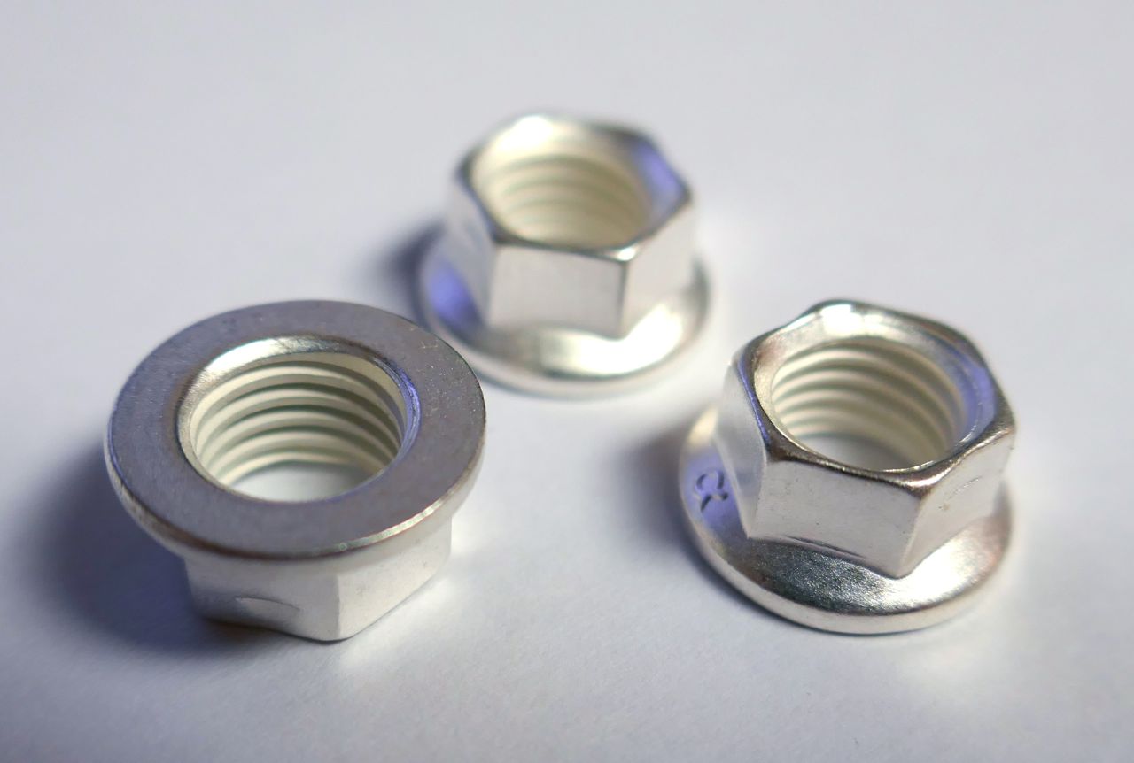

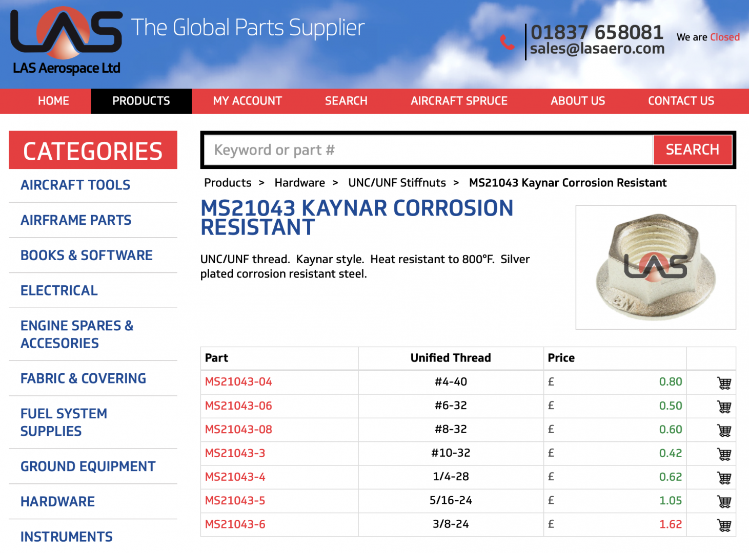

See if you can get hold of the silver plated Jetnuts/Kaynar nuts. These are corrosion resistant & rated up to 800F (426C) so ideal for our application.
The size we use are 5/16"-24. Available from LAS Aerospace in the UK.
Andy

Thanks for the information Bunny, order placed👍
