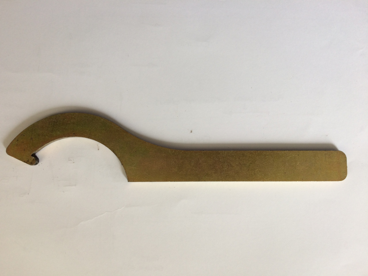

Does anyone have the C spanner size? I need to get some TIA

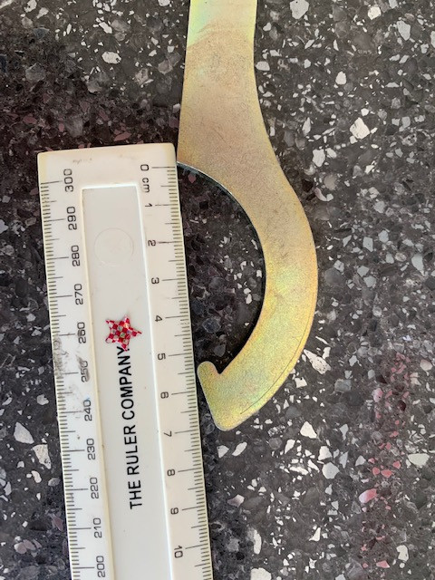

How do you measure a C spanner?
As best as I can measure it, it's a 60mm diameter.

I think 60mm is too big. You will need two of them and they should have been supplied by whoever fitted the suspension. I tried to purchase a pair but struggled to get the right size so went back to Berrybrook and they supplied the correct ones.

Logically I guess, the answer is to measure the diameter of the adjuster collars.
Or give Dan White a call at SSL.
