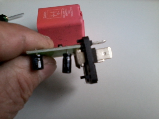

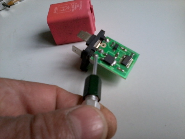

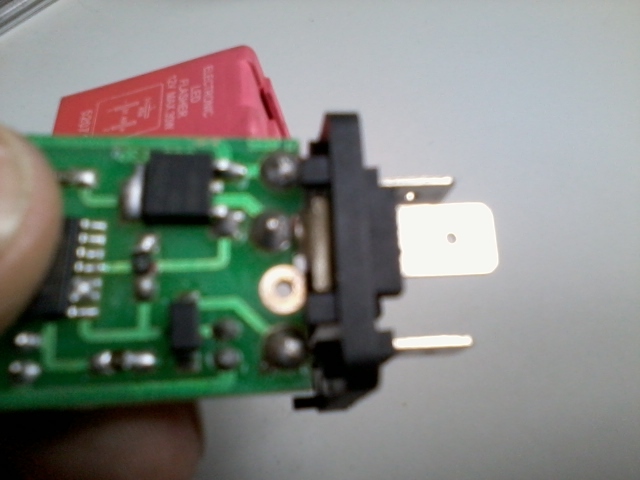

After a fuel pump failure I have just looked at the flasher relay which works only when it wants, the two electrical plugs are unsoldered from the pcb, the engine vibrations with the 132 cub even managed to trigger the steering wheel control during the period of engine break-in I would give the result after having redone the welds.
