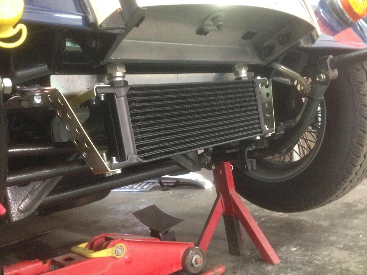

MOG414_Aluminium Valance to cover oil cooler insta

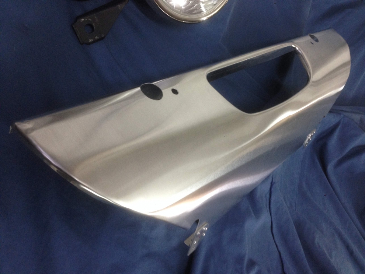

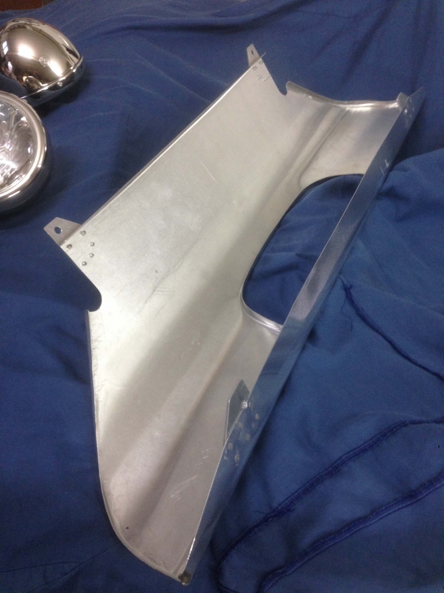

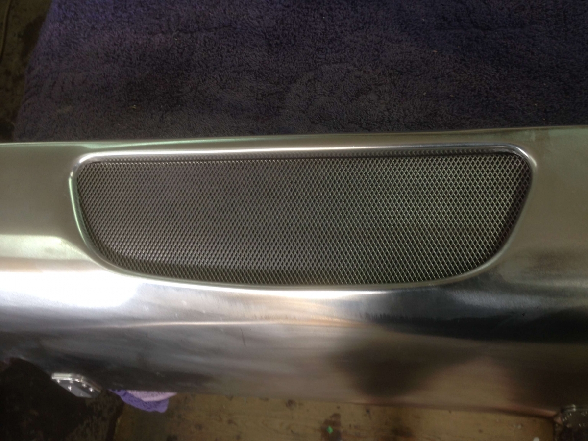

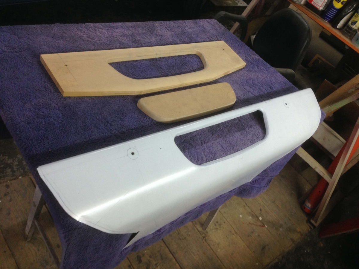

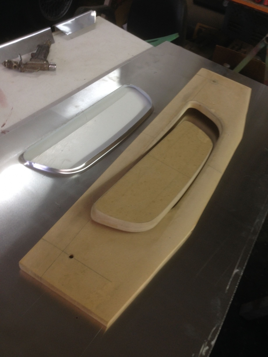

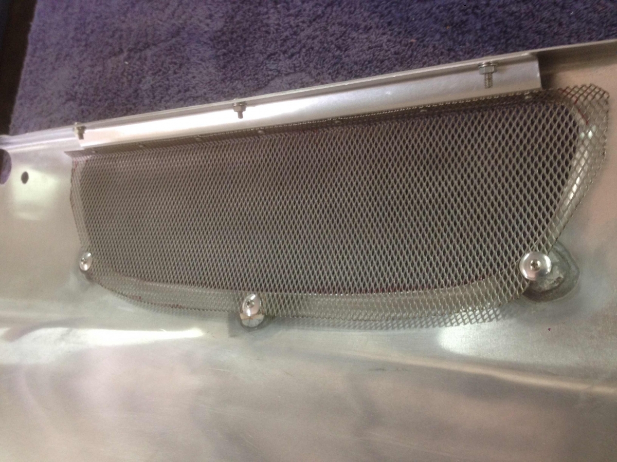

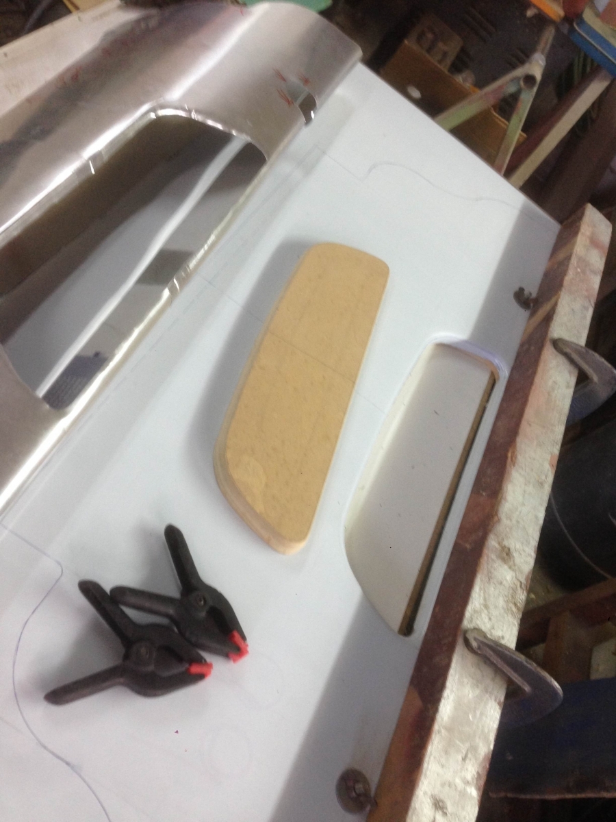

Fabricating of intake male and female dies in fibreboard to press out the lip of the intake on commercial aluminium sheet plus forming and fitting to MOG414.
Again, this was mounted to existing structures so that no new holes were drilled in Ms Marple.

Excellent work Reno, forming the little grille aperture without distorting the curve to the valance takes great skill thumbs

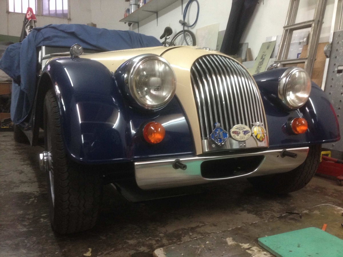

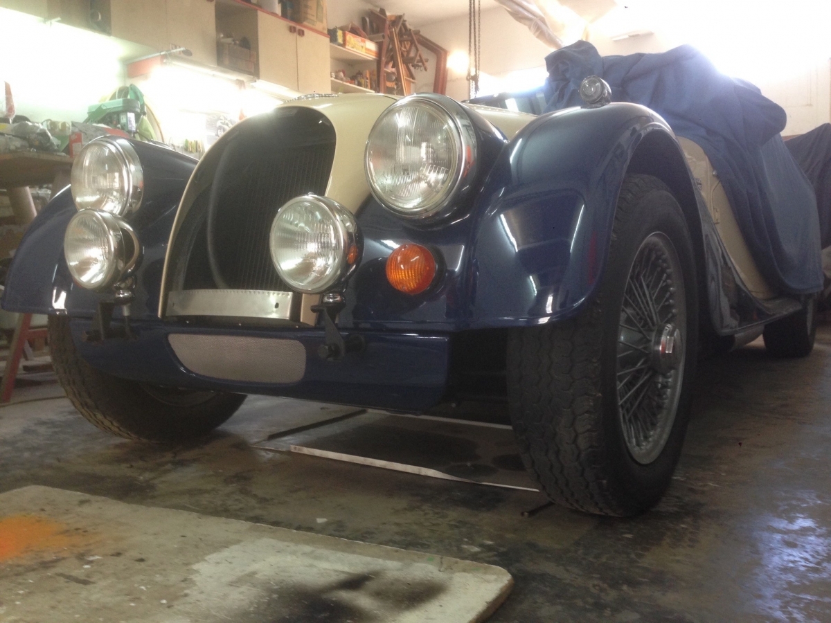

Very nice lines that suit your Morgan. I really like the soft edges and trapezoid shape.
