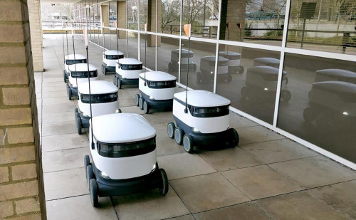

Originally Posted by Saxonian
All the Amazon delivery vans that deliver in my neck of the woods are EV's
In MK they have these, that deliver Amazon stuff and Takeaways......
Posts: 3,824
Likes: 69
Posts: 3,824
Likes: 69
I'd love to see a few of those crossing the road......bystanders reactions would be good.
