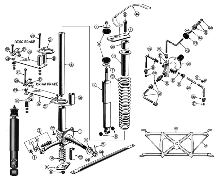

Top right in this photo is what it looks like (on earlier Morgans with the mechanical oil pressure guage)
Joined: Nov 2018
Posts: 6,676
Likes: 441
TBM Online Content
Joined: Nov 2018
Posts: 6,676
Likes: 441
The tubes marked '40' got to the top of the king pins, and '38' goes to somewhere on the engine block. 42 goes to the back of the mechanical oil pressure guage. If your oiler has been removed, and you have a mechanical oil pressure guage there may just be a tube from the engine block, through the bulkhead and directly to the guage.

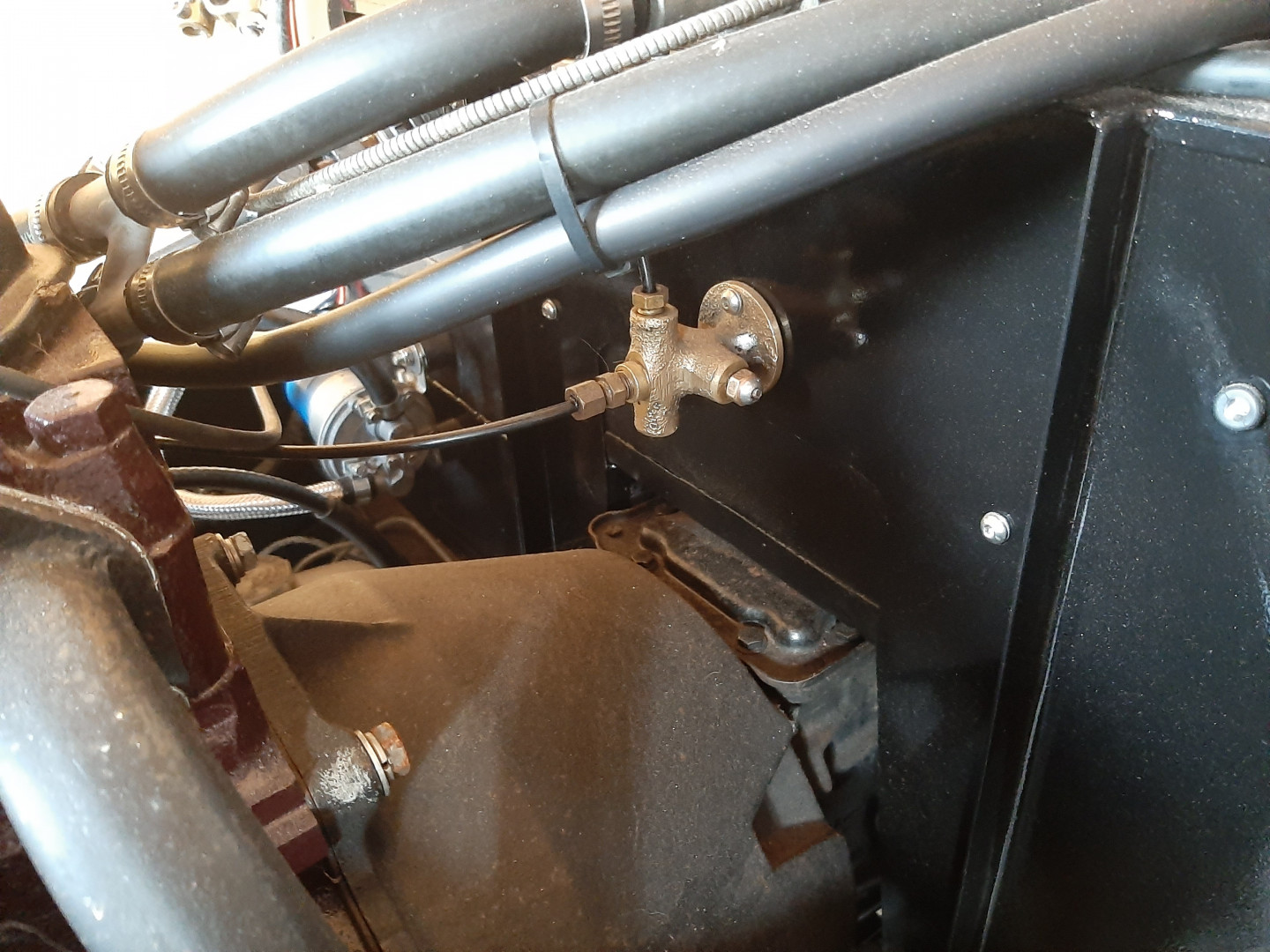

This is what it looks like under the bonnet (mine has the pipes that go to the suspension blanked off as I have fitted grease nipples there in their place) ....
The operating button sticks through the bulkhead above the gearbox tunnel by about 50mm and is about 20mm in diameter ..... they were sometimes removed by owners if they leaked. See if you have grease nipples on top of the suspension uprights as this was a known modification

Thanks for that. Can you tell me where I can obtain exploded parts diagrams for my Morgan, like the one you have shown please.

Thanks for the help, I have now located the components, amazing what a photograph and a diagram can do.
